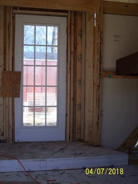

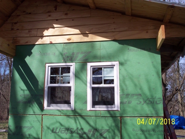

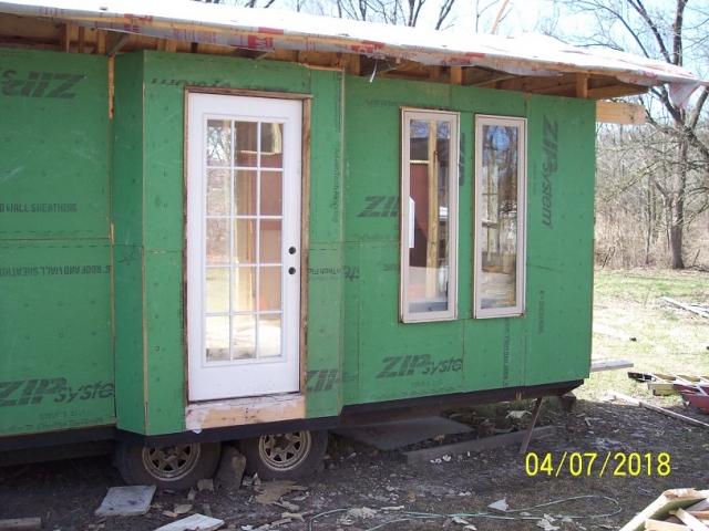

Postby bobhenry » Mon Apr 09, 2018 2:58 am
Well Sunday was the best day this weekend so I put in 8 hours and got the other bump out framed in and the big 27 lite fixed window installed. Woke up Monday morning ( my last day off) to about an inch and a half of new snow. The Hell with it I will get the framing skinned today one way or the other. When this is done the entire tiny will be weathered in. It will still need the steel roof installed and the exterior finish sided but I can heat the inside to at least work on the electrical during our May and June blizzards :rofl2:

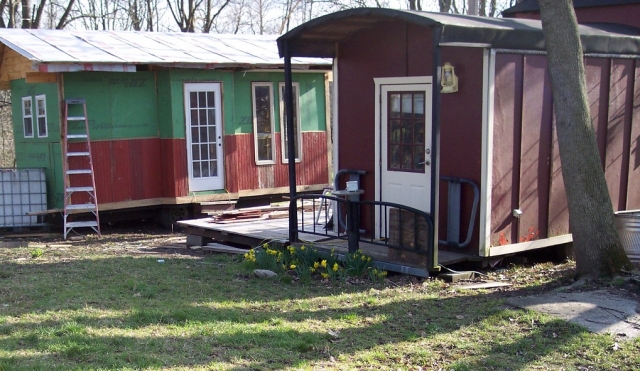

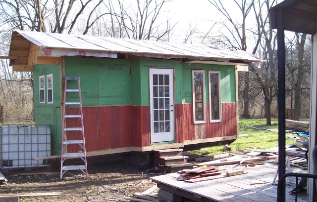

Postby bobhenry » Tue Apr 17, 2018 12:34 am
Friday My helper and I installed the v grove recycled siding on the front of the Depot. It is complete nose to tail and just 1/2 way up the wall. Saturday and Sunday were cold blustery days so we retreated inside out of the wind. We removed the 2nd 4th and 6th bottom member of the roof trusses. There are now 3 open and airy sections ( I refuse to call them rooms). The roof line was sub framed to accommodate a modified vaulted roof line.
We were also able to get about 1/2 of the tiny wired for 120 ac With duplex outlets. It is nice to have power here and there now instead of a single extension cord to work from. We also got a very tiny start on installing the 4" polyiso' foil faced ridged insulation in the wall cavities. It was a very productive weekend. Oh I splurged and spent another $7.50 on construction screws. I need to update my costs to date.
