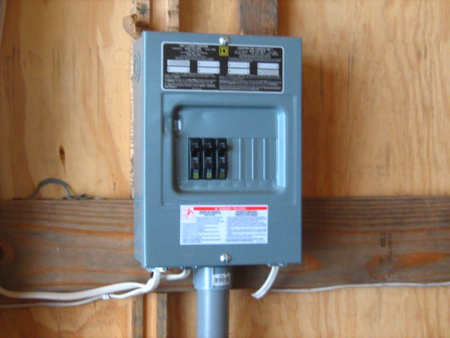

After the $583.00 installation fee for the electrical drop, I just spent $753 on materials for the service. Luckily my main guy helping me with the install will probably only cost me $300.00 - This electrical adventure is almost more than my build cost :thinking:
Well the pole is up ,the meter base and disconnect is in, The panel is in the tractor barn, and with a little luck I will be ready for final inspection by Friday. :D

Well the electric is in ! :P Image
Took about 3 1/2 hours to get the underground cables in and hooked up. Of course there was the ONE MORE TRIP to pick up breakers. The ones I had didn't fit the new break box. :x
I am waiting for the boys in the big white truck to hot me up and stab in the meter.
BUT I am done !
On to building slider doors for the tractor barn and batten down the rubber roof on the caboose.
I know ..... I would have had the roof done but it's cold enough now I need a heat gun and that takes electricity.
I used every stitch of my found electric wire and only had to buy 25 feet too completely wire the barn. Yes I am the king of cheap !
UPDATE THE LIGHTS ARE ON AS OF 4:20 LAST NIGHT ! :thumbsup:

The final straw was getting back to the barn I decided to use my circuit tester to check the wiring as I had had two light bulbs blow upon installation ?????
I had all kind of real crazy combinations of light codes on the tester. Some of which were not even on the code diagram. I called my electrician buddy that had tutored me thru the service installation and he scheduled to check out the problem early Sunday morning.
Before I tell you what we found , in his defense he is 71 and has been an electricial 40+ years of his adult life. On the day we installed the service he had just climbed to the top of a 30 foot meter pole to install the weather head then we worked four very busy hours.
Fast forward to Sunday He opened the box and started laughing. I took offence he was laughing at my attempt at wiring the breaker box and he quickly said NO and pointed to a connection he had made earlier in the week. Seems we were not paying attention and had put the hot wire on the neutral and the neutral on the hot lug.
This means that 120 volts were being delivered to each side of the outlets and the ground was being used as a default neutral. 240 volts to a light bulb makes for a real short life span. We corrected our error and all is well. I learned a breaker box collects 2 phases of electric and each side work on a separate hot leg. I got dumb lucky once again. This error only affected one side of the building. Luckily the caboose was connected by a huge extension cord to the good side. Had it not been connected this way the 8 transformers for the led lighting and the AM FM CD player and the fridge and freezer would have been toast.
:worship: Thank you big guy ! :worship:

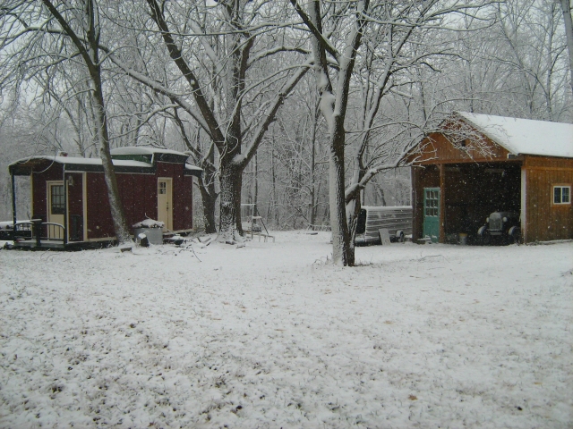

Well winter has arrived
I had a buddy lined up to help me with the barn doors and then winter arrived.
