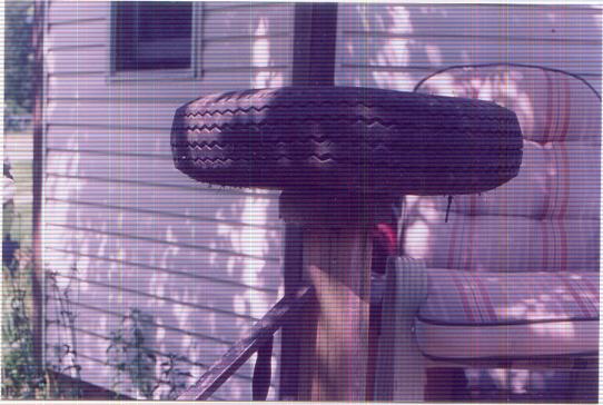

Postby bobhenry » Mon Mar 02, 2009 6:40 am
I got curious this morning and went to a nice write-up on the Conestoga wagons and found a neat little curiosity.
"I'll be there with bells on"
I found a explaination for this often used quote. It seems it was a common practice to have bells on the tongue of the wagons to help alert anyone of the approaching wagon. In heavy weather and dusk / near dark conditions they would warn other approaching wagons.
It seem that if a hapless wagoneer was unfortunate enough to get stuck or brokedown in such a manner that he would take assistance from others he was expected to surrender his bells to the rescuer.
I'll be there with bells on therefore means you can count on me to get there without a problem.
Maybe if I installed some bells on my tear I could arrive at a gathering without my customary tire problem. :thinking:
Can you say ply seperation !
How about Damn Bolts !
