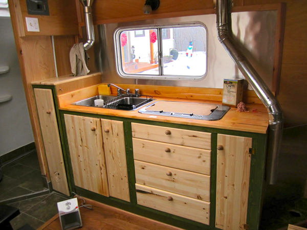

Hello Everyone, I just wanted to post my recently finished pride and joy. it is a 17 foot teardrop style with a raised front. It is built on the chassis of an older aluminum travel trailer and it has most of the amenities of home. Right now my partner and I are living in it in Ontario. Here is the link http://tinyhometeardrop.blogspot.com/

Thanks guys, yea this forum is a great resource. i was in victoria briefly actually about 3 weeks ago though. We were driving through to catch the ferry to Port Angeles.
I know its not exactly the tiniest trailer but my intention was to build it to live in full time so it had to be somewhat comfortable.

:thumbsup: :thumbsup: :thumbsup: What an inspiration for small living spaces! Great job! Are the both heater flu's for the diesel heater? Did you consider venting out the side wall? There are some nice Suburban heaters that will vent nicely out a side vent using propane.

They are 3" flues for the cabin heater and the hot water heater. the cabin heater is a sig marine 100 diesel heater and the hot water is marey takless water heater. both of them required a certain flue height so i needed to poke it out of the roof.

the trailer is holding up pretty well so far. I have had a problem with the grey water outlet freezing. it is just running outside into a portable holding tank. when i was traveling with it the pipes were capped and some water was left in them which ended up freezing completely. A full tank of water lasts almost a week just doing dishes and we use water sparingly. we havent really used the shower yet because i have a few more finishing touches to do in the bathroom and we havent really been parked in one place for long enough to settle in and get everything set up completely.
im guessing the showers will be quick and seldom when we do use it.
We have two deep cycle batteries hooked up to an inverter which is then plugged into the main breaker box. the batteries are trickle charged by the truck while driving and two 20 watt solar panels mounted to the roof. We have been using the power to run our lights which are all LED, a computer with speakers, the water pump and a small fan. the last two are hooked up on a 12 v circuit.
For a toilet we have a bucket toilet and i am going to try and incorporate a composting system eventually.

Firemaker, I'm curious. The picture of your bed begs a few questions about your set up:
What are the dimensions of your bed and what is the ceiling height once in? Can you sit up in it? And what is the height of the opening for entry. Judging from your girlfriends shoulders, it appears to be a very slim entry??
Do you keep a small ladder somewhere to climb up? I can't tell, but is the edge of the bed recessed from the ceiling overhang so that you don't hit your head when climbing up?

The bed is 4 feet by 6' 4" the ceiling is curved so only on one side of the bed is it high enough to sit (leaning against the shelf not upright). There is about 3 feet from where the bed ends to where the lower ceiling begins.
Right now we are using one of the stools and the coffee table to climb up. i plan on making a small step eventually.
