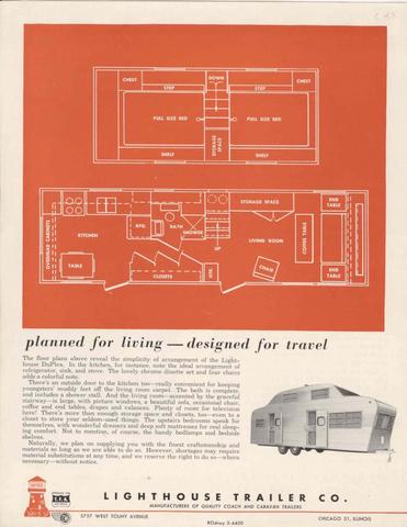

Here is the very ingenious Lighthouse Duplex from IL, @1951-53. It was
@ 8ftx28ft body size and 11ft6in high per their brochures. It had 2
"upstairs bedrooms" and a rear kitchen:

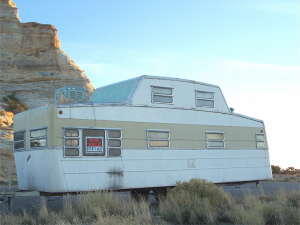

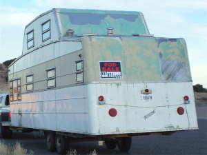

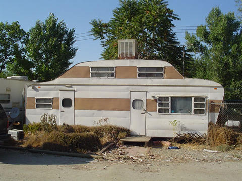

Here is an evidently one-off Travelite from TX, @ 8ftx26ft body with a rear
bath @mid1950s: It had 2 upstairs sleeping spots under the raised roof
section. It wasn't as sophisticated as the Lighthouse in that area. I
believe the "TruelyVintageTrailers" web site has a few more pics of this.
It won't come up at the moment so you'll have to enter/Google that to
see them. Here are a couple:

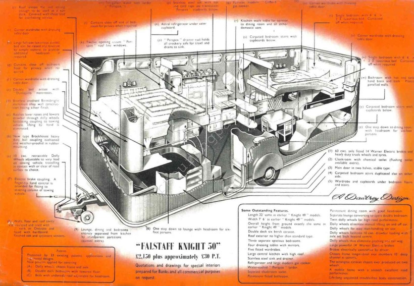

And lastly, here is a very ingenious 1951 UK Caravan, the Falstaff
Knight 50 by the UK builder, Coventry Steel Caravans [even though
it is built of aluminum extrusions]. I found it on the great Australian Vintage
Caravan site "Our Touring Past". This post is for a single level Silver Knight
15, but at the end of it is a brochure page for the Falstaff Knight 50, which is a
DD. The posting shows the unusual construction and design[s] of both.
http://www.ourtouringpast.com/forum/vie ... f=14&t=480
These are very unusual looking, but they grow on you once you see what
they are all about. The designer was way ahead of his time. The Falstaff
has drop floors, front and back and and 3 "upstairs" bedrooms. A double bed
up front and two singles in the back, each in its own "room" and 3-4"'staircases"
to reach them! It also has a dropped floor entry step with a dutch/stable style
entry door.
Here is a pic off the brochure on the 'Our Touring Past' site of the Falstaff
Knight 50 model. [this shows up at the end of the posting.] Someone had
imported the Silver Knight 15 into Australia evidently, and due to that, we
ultimately have this information.
Pic on the web [easier to magnify to look at.]:
http://www.ourtouringpast.com/forum/dow ... 4&mode=vie
Here's the above pic:
