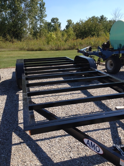

Trailer
Here is the bare trailer fresh from manufacture.

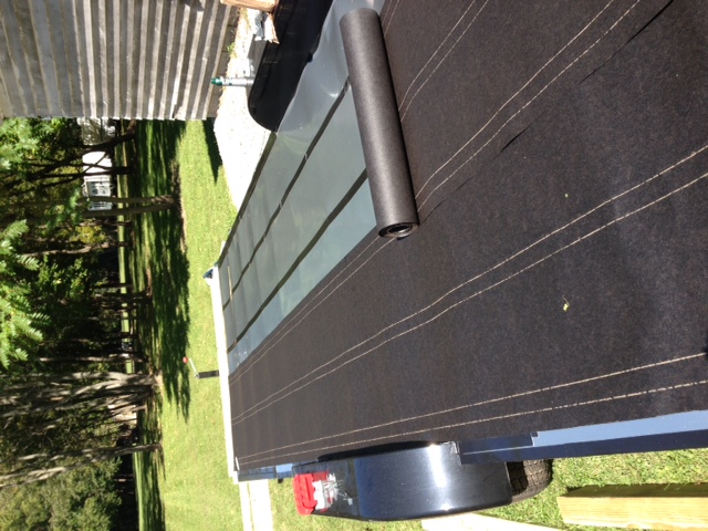

Postby camaro2813 » Wed Oct 01, 2014 11:54 pm
Flashed the underside with aluminum and then 30# tar paper
flashing small.jpeg (154.49 KiB) Viewed 6336 times

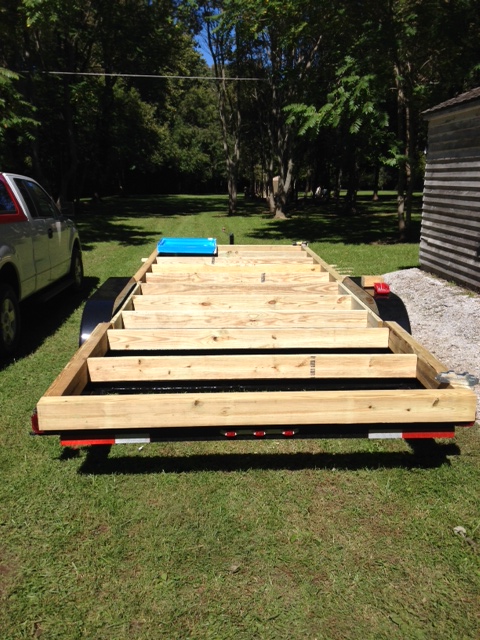

Next up we had 2 layers of 2 inch R10 foam, and one layer of 1.5 inch R7.5 foam. Our floor is R27.5!
insulated small.jpeg (134.1 KiB) Viewed 6336 times

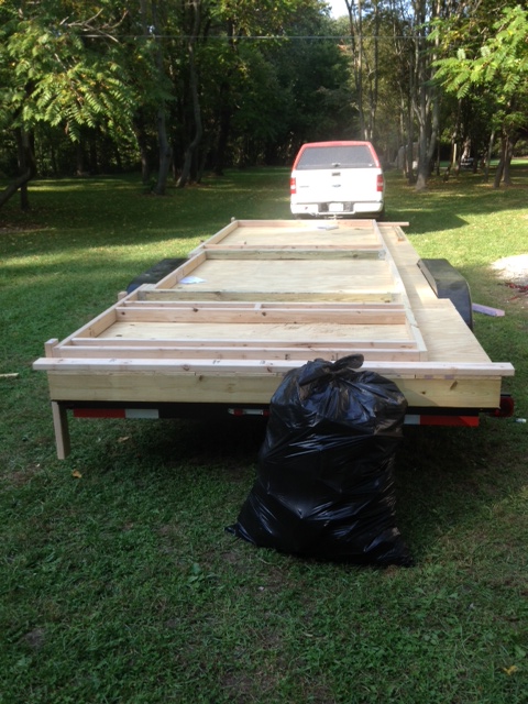

Postby camaro2813 » Thu Oct 02, 2014 12:00 am
Here is a photo from today, The trailer has been fully decked with Tongue and groove Plywood, glued and screwed down. I am constructing one side wall as of now. Hopefully both shall be done this weekend. Coincidentally, this Sunday will mark exactly two weeks since we first started working on the house.
sidewall small.jpeg (170.92 KiB) Viewed 6336 times

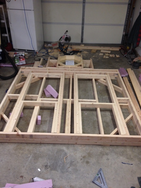

And finally, here is the rest of my evening. I finally got BOTH end walls entirely framed in. Here's hoping for 4 freestanding walls by Sunday!
sidewalls done small.jpeg (131.48 KiB) Viewed 6335 times

Postby camaro2813 » Thu Oct 02, 2014 12:03 am
camaro2813 wrote:Here is a photo from today, The trailer has been fully decked with Tongue and groove Plywood, glued and screwed down. I am constructing one side wall as of now. Hopefully both shall be done this weekend. Coincidentally, this Sunday will mark exactly two weeks since we first started working on the house.
Interestingly enough, that single garbage bag you see there in front of this picture is the ONLY waste generated out of this build so far. I am trying to keep a tally on how much trash we send to the landfill through this endeavor.

If you hadn't flew by it too fast I would have warned you to think about water and gas lines routed thru the joist. You have a second chance low in the walls keeping them near the heated side of your insulation. I speak from experience I have to retro back to get my water lines in and my gas line will now have to run under the frame. I wished I had thought it out farther back the trail.

I have been mindful of utilities. Both the kitchen and bath are are one far end. Since we will be using this year round, there will just be one short plumbing run along the end wall to supply the kitchen sink and shower. My intent it to have these lines inside the kitchen cabinet for maximum freeze protection. Drainage will be cut thru floor after the fact. Gas lines will be run under the frame RV style.
