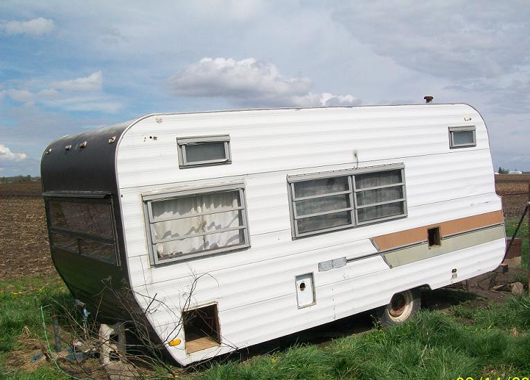

I am sorry that I think what you are trying to do is a bit ambitious for the little red trailer. One of our Hoosier group just purchased a very nice little serro Scottie Sportsman trailer for $150.00. In the past I have purchased a 7 x 16 for a cool $100.00 so the bargains are out there. I truly think you will save yourself a ton of work and possible heartbreak if you were able to start with a frame from one of these style trailers. If you see one setting unloved just stop and ask you will be amazed the bargains you may find.
here is one I found for a buddy for $50.00
