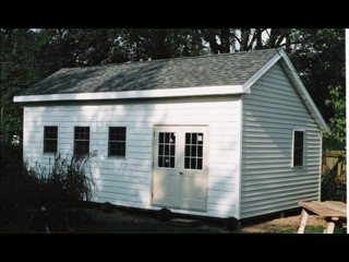

Here is the single prettiest barn I ever built....... Image
