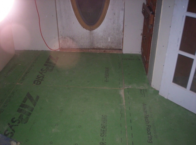

Postby bobhenry » Fri Jul 13, 2018 6:32 pm
THE ALUMINUM FLOOR AND SIDES IN THE FLEA MARKET FLIVER CREATE A DEAFENING RATTLE WHEN ON THE ROAD.
Oops cap lock alert.
I still have about 800 sq ft of 1 1/2 insulated Zip panel. It will be pieced in to make a floor and the sides offering an R 8 insulation value that will be added to the foam I have already placed in the walls between the ribs. I feel this addition will significantly soften the road noise. I used it in the house in a house build as flooring over the cold concrete floor and it was one of the best things I have ever done.
