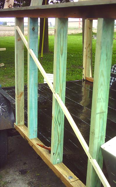

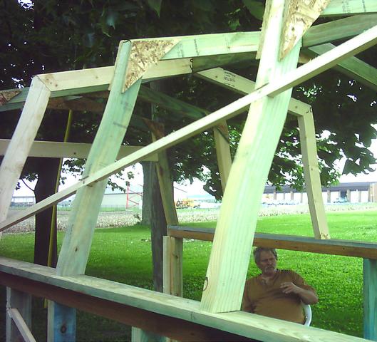

Postby bobhenry » Fri Oct 04, 2019 4:31 am
What is wrong with downsizing the let in wind bracing it worked in the roof trusses and side walls of the barn camper..........
they were incorporated on all four corners in the walls and the roof with excellent results for 6 years and several thousand miles.
