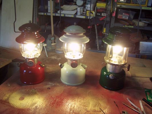

O.K., I went out and got my last brand new generator and put it in "Minty". She seems to work better, and lights up faster, but still sputters a lot. Until it /she settles down, I have a fireball, and a lot of soot. I think the needle valve is worn on this one, because the more I play with it, by half closing it, or turning it slowly, the faster she comes up to full steam...... will do more research.... :thinking:
I then got my red 200 and put on a new mantle. Pumped it up, and she hissed real nice. Filled her up, pumped her up, and turned her on............Nothing!! :x Took her apart...... The generator was completely rusted inside the tube........Gotta make sure she's real dry after cleaning....DUH...... :oops: . Didn't have another generator, so I grabbed the old/new one I pulled out of "minty" and put it on. Still no fuel, :x so I took the whole thing apart and checked the air/fuel tube, took it apart/cleaned it/ stretched the spring, and put it back together again. :worship:
Pumped it up about 50 times, opened the valve a 1/4 turn, lowererd the needle valve, applied the match. :worship: ........SWOOSH! Lit perfectly!!!!(I bet you thought it blew up didn't you!) :lol:
So Now I have three working lantern.....Red 200, Minty200A, and a 335 that I pput together from junked parts. I have enough parts for one more complete 335 .

They really look great John and you did a nice job on them! I've had 1 or 2 do some sputtering when I first lit them up after rebuilding them. Ran them for about 45 min each. Seem to work fine now. Congratulations on a job well done! :thumbsup: Doug

You got them all working. That's great! :applause:
