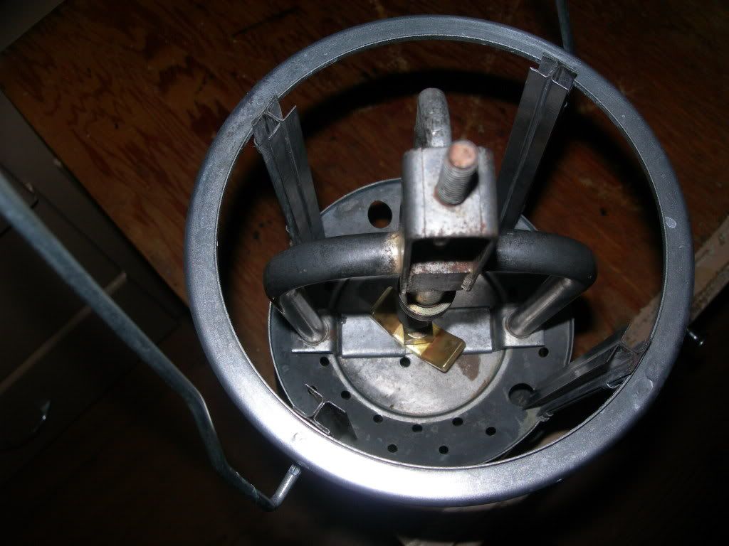

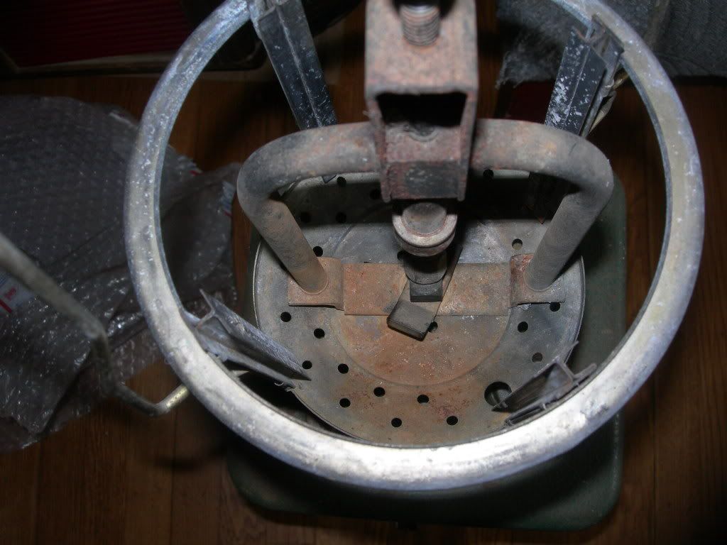

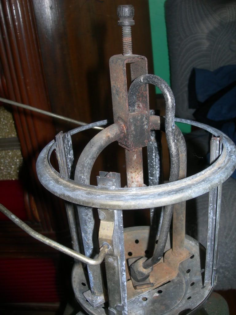

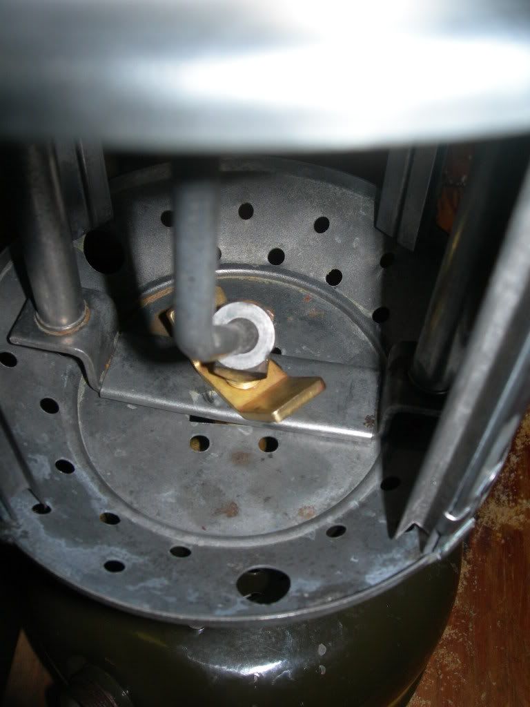

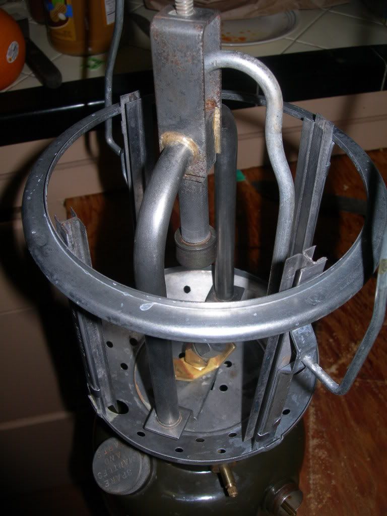

This is what I did.
I took a gallon size plastic tub. (I plan to buy a heavy 2-3 gallon bucket with a lid for the future.) Filled it most of the way with warm water then put a liberal amount 1/4 to 3/8 cup of cleaner. Mixed it up and then put in the rusty parts.
I let them sit for 15-20 minutes then pulled them out and scrubed them with a Scotch Brite type kitchen sponge. On the tougher crud an SOS Pad. Brass takes maybe 5 minutes.
I plan to save it and reuse it.
Here are some before and after pictures.
