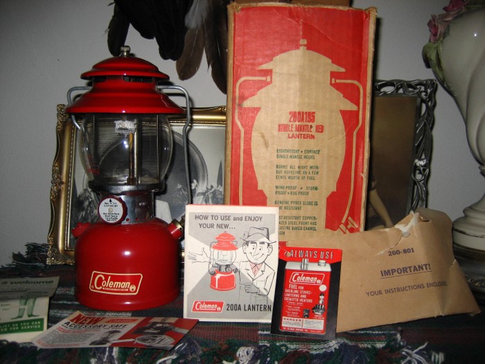

Uhhhh...this thread got me all excited and I ....uhhh...humm... bought some "BLING" for the SlumberMAX!!!
:P :P :P
There are two..one is a 1970 and one is a 71...both are real nice. I've decided to go Coleman fuel as opposed to propane.
The two lanterns will get built in cases in the galley (iffn I ever get to that) !!! Now if I ever get this thing done....

Alright Dave!!!!....welcome to the world of WHITE GAS!!! Nice lantern. It'll work for you fine. These things are almost bullet proof! What's cool, is that you are going to go camping with a lantern that is 38 years old! Propane and batteries....Just say no! I think you'll find that for gas mileage vs. cost...you're ahead of the game. But that's just my opinion, not to mention the nostalgic pluses, ya know what...it just has that "campin'" look... nice lantern...really nice! Doug :applause:

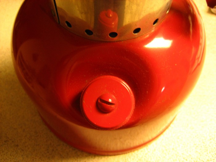

One thing that is highly recommended is tho replace your fuel cap if it has a screw in the middle. There is a design flaw. If you loosen the cap while under pressure it will blow fuel out the vent hole on the side which could cause a flare-up if the appliances are still hot. The replacement caps are available almost anywhere you can buy Coleman camp gear. They a less than $4.00.

Nice catch...I would have never known :thumbsup:

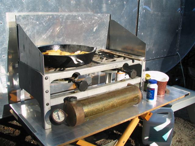

Here's what I cook with, a Sea Cook alcohol boat stove. It's pretty darn old, but man is it hot!! it's cast aluminum with a brass tank, I made the aluminum splash guard, it goes with my aluminum trailer theme. I actually found this along the road alot of pieces were broken off you can see the top corners still missing, and big dent in the tank. Image
