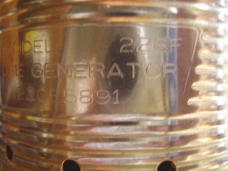

So the lantern came today. Looks nice, I have to put some mantles on it before I can fire it up. I will send more pix later.
Interestingly, upper part is stamped 228-f, so it must be a 228-f top on a 1951 base (?)

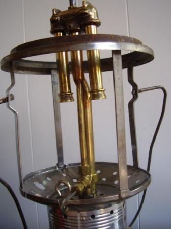

Here is a picture of the inside (with glass and top removed)
Early indications are not good - Can't get it lit, the pump is shot. Might try to run up to SuperWalmart to see if I can get a pump for it...

Meanwhile, I got the stem out of the pump, lubricated everything with some 3in1 oil, and it seems to pump up and hold some pressure now. At least the pump starts showing some pushback after a number of pumps, and you can feel pressure escaping if you loosen the cap.
But it still won't light. What I am NOT hearing is the hissing noise when I turn the valve on, that I hear in my other lantern, so I am thinking the gas is not getting up into the lantern.

Al.....put a little pressure in the tank, crack the valve, then spin the tip cleaner, the little wire loop. If it's in the wrong position, it won't allow pressure to come out the generator. On a lantern....it's not an "up to light" thing like on a a stove. It just rotates to clean out the crud in the end of the generator. It's down to light....but that may or may not be your issue. Doug
