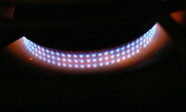

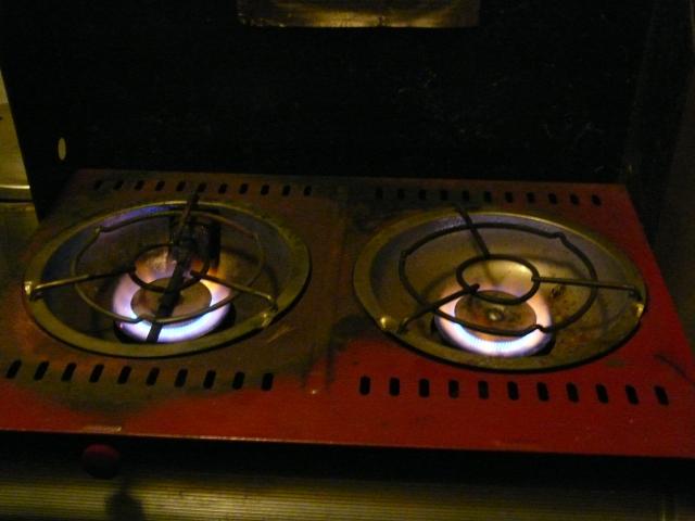

I worked on my Ted Williams stove a bit today. The pump was leaking a bit like many of the AGM/Thermos pumps do threw the check valve. I was going to put an O-ring on it but while it operates like the AGM pump and uses the same O-rings for the pump plunger and tank seal the check valve does not come out nearly as far as an AGM so there is no room to put an O-ring on it. BUT. I did open the valve and brushed the seat with my tooth brush. ( time for new brush ). It is is now working and no leaks so far. May have to try this on some AGMs and see if the O-ring can be avoided.
Here is the money shot. On start up it takes a while for the stove to settle down then it burns like a champ.
I am now simmering a kettle on it.

Good work Randy and great pic. :thumbsup:

Nice burn! :thumbsup:
