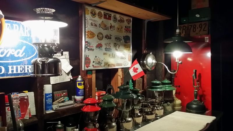

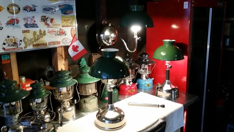

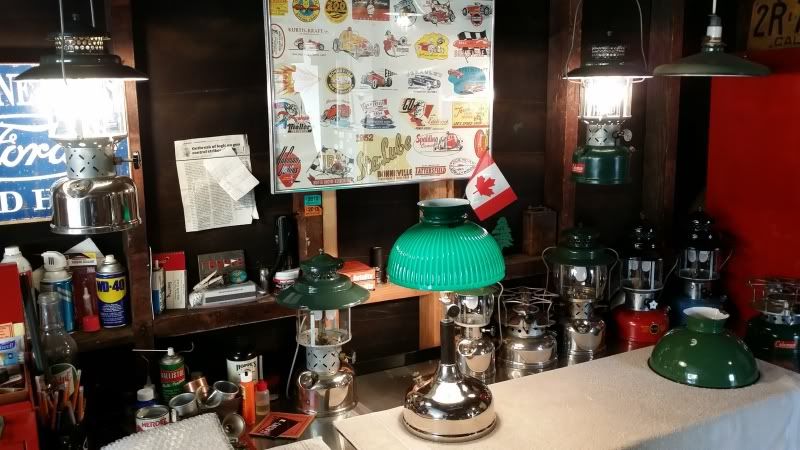

Guess I should stoke the coals, here...
The trailer project continues with a good ponder... I'll finish it eventually.

Tasty looking stove! :thumbsup:
Re: Coleman Keepers Campfire come on in!
Postby Wolffarmer » Mon Jul 14, 2014 4:45 pm
Not enough bacon grease on that stove yet to be tasty.
Nice collection
Very nice

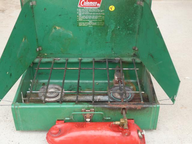

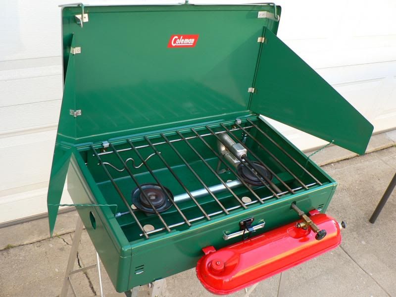

I stopped at an estate sale today and found a 425E. Not like I need more stoves but I do not have a 425E. And the price was right. Buck and a half. It was half price time so the $3 tag was cut in half. Stove is a bit crusty but if you look past the crusty and scorched paint does not look to be used much. At home the pump would not make pressure at all. Pulled it and the leather looked like an old shoe one finds in the desert. Neats footed it and worked it in for a few minutes and pump now works like a champ. Inside the tank is a bit of fuel. Shine a light in there and can not see any rust and it smells like vintage CF. Screw cap on and give it some pressure and it does not leak. Fill it all the way up with CF and after I blow the bigger crusties out with the air compressor it fires right up. Probably first fire in 30 years.
Tank is dated 3 74 and the case is 4 74.
Ok, if you need photos.
It has fire.
The 425F I have in my trailer might get replaced with this one. That 425F has seen a lot of use. But last month I did use it to bake a pie. It even got the oven up to 450 once. Scorched some paint on it as the oven just does not fit these to good.

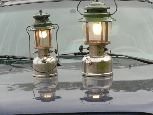

Well last weekend I was looking through the Coleman Collectors Forum and low and behold I see an add from one of our neighbors to the north. One that he is selling is a 242B 9 50!!!!!!!!!!!!!!!!!!!!! I could not get a PM off quick enough as I happen to have the cash right now ( probably be singing a different tune in Dec. ). That is my birthday lantern and as those of you that are really into this affliction know are very hard to get that date down here as the US Colemans was stamped B 50. Just not the same thing to have a lantern that could be made from July to Dec. So here it is.
In chatting with the seller found it would only cost a bit more to ship a second lantern so I also bought a 236 from him. It is a 4 60. The big guy on the right. They are setting on my Canadian built Chev Tracker.
They came Saturday and yesterday got out and worked on them. The 242B had some strange sludge in it, not soluble in CF. I bb'ed the crap out of it. Literally. Got most of it out, clean up the pick up tube and stretched the spring a bit. And it fired up. I put on a mica globe that I had ordered the day before the lanterns came up for sale, for a different 242 so it went on this one. I think it give it a different look.
Now the 236......what can I say. it is like a super sized 242. In looking this one over fount was rather clean and the generator looks like it had barely been used. Put it together and it fired right up with a Peerless 24A mantle. It has a made in England globe so the shape is a bit different. I like that 236 a lot. Very nice lantern.
