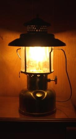

Its alive! Frankenlantern lit 8/22/10
Postby Alfred » Sun Aug 22, 2010 8:20 pm
Hey gang,
Its alive! Got Frankenlantern lit!
Yes, the piece that goes up/down inside the assembly was bent and not going down into the pipe correctly. I got it straightened out and the new generator in, new mantles, and it lit right up!
Cool!
AL in Asheville :thumbsup:
