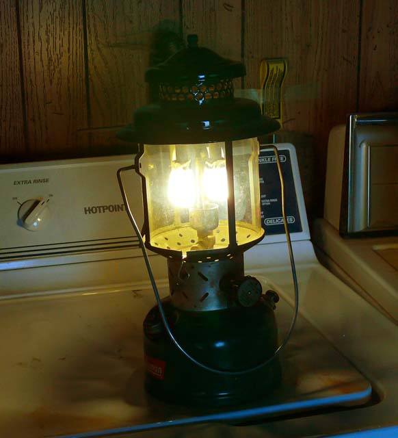

Oh, I was using my torch to make a part for a 220E kerosene conversion. It is now burning happily away on kerosene. Photos to follow.

HERE IT IS.....WHAT YOU HAVE BEEN WAITING FOR.
haven't you?
A 1955 220E burning kerosene. I use a #6 jet that I found in a 220D and a home brew priming cup made from a 6.5x55 Swedish Mauser cartridge and an end cap for 1 inch copper pipe.
8)
Randy

Postby doug hodder » Sat Jan 28, 2012 7:33 pm
Looks great Randy! That's some "shade tree" lantern mechanic work....good idea. Doug
Postby DragonFire » Sat Jan 28, 2012 7:34 pm
holy smokes! "shade tree" is right!!
Looks great! :applause: :applause:

Postby Wolffarmer » Sat Jan 28, 2012 7:35 pm
that 6.5x55 Mauser really fits the bill. I just soldered it on. I don't think I could braze it. I am not worried about the solder melting as I have seen match sticks lay in the bottom of the cage for many hours and not char.
