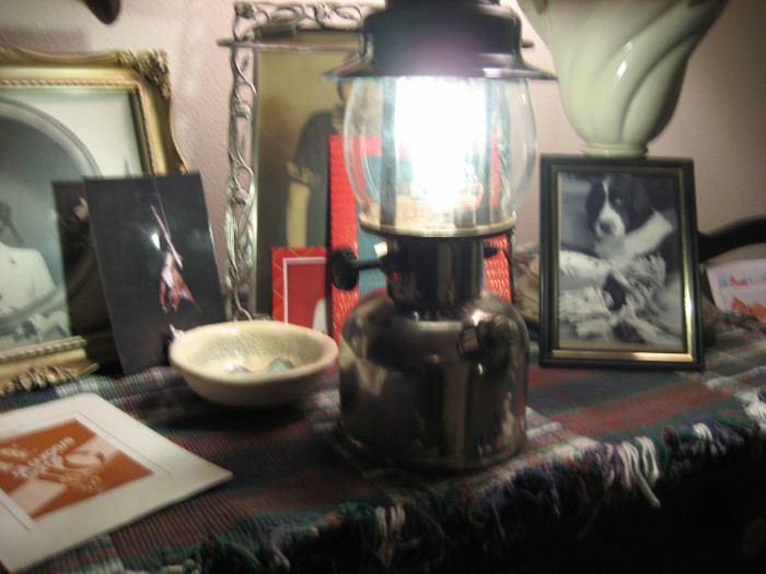

Postby Juneaudave » Sat Jan 10, 2009 10:47 pm
Hey Jeremy...solved the leaky on/off valve thing on this 242, and fired it up!!! Pumped up good...fired excellent...but it is slowly bleeding off pressure somewhere...I'll swap caps and do the liquid wrench thing tomorrow!!! I fired it with the original cap just for giggles...

Postby rainjer » Sat Jan 10, 2009 10:58 pm
Looks awesome!!! It is most likely the fuel cap gasket. I am placing an order for some new gaskets when I order my Sears decals this week. I can get a couple extra and mail them to you.

Postby Juneaudave » Sat Jan 10, 2009 11:39 pm
rainjer wrote:Looks awesome!!! It is most likely the fuel cap gasket. I am placing an order for some new gaskets when I order my Sears decals this week. I can get a couple extra and mail them to you.
Jeremy
It's got the original cap with the screw and hole in the side...and the screw is loose.
If a gasket will work, that would be great!!! Would it be better (for a working, daily driver, lantern) to just get a one piece cap? These things are alot of fun to play with...Thanks Jeremy for all the tips!!!

Postby rainjer » Sat Jan 10, 2009 11:50 pm
I'll let you know when I get them & get you address from you. The 242 uses a smaller fuel cap than most other Coleman lanterns. You are kinda stuck using the original fuel cap and replacing the gasket. Based on the picture of the cap, it look like someone used a pair of pliers to tighten it.

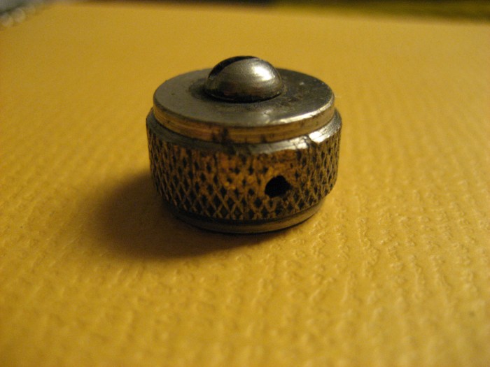

Postby bg » Sun Jan 11, 2009 9:53 pm
I see that the vent is actually 'broken' now - I never quite understood that before.

Postby doug hodder » Sun Jan 11, 2009 10:06 pm
sorry, but for an item like that, your best bet is a parts lantern or a trip to E-bay. That's not sitting on a shelf anywhere nowadays. Doug
Postby Micro469 » Sun Jan 11, 2009 10:53 pm
You'r gonna spend too much money fixing it...... Send it to me. :roll:
Actually, if the vent is held on tightly with the knurled knob on top, you can probably use it just fine for the time being. Then, in the future you can look for another vent. :thumbsup:
