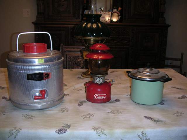

Postby Rock » Wed Feb 25, 2009 7:48 pm
Hijacks welcome, John. That's how we all learn.
Here's my 200A, vintage water jug and a cool little porcelain pot with a chromed lid.
The Aladdin in the background has been around for awhile.
And for the record I don't hate Hodder. What a cool hobby.
Thanks for all the help/inspiration.
