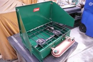

Postby PresTx82 » Sat Mar 07, 2009 9:07 pm
I've taken apart my gas tank assembly on my Coleman stove for cleaning and cannot get the gas cap off the tank. It's on tight. I've soaked it with liquid wrench, WD-40, etc. I don't want to use my pliers with brute force as I don't want to put deep gouges in the gas cap. It's in prestine condition. I started to do it and made little "teeth marks" in the cap already.
Is there any little tricks I've overlooked before I engage in brute force?
Mark
El Paso, Texas

Postby PresTx82 » Sat Mar 07, 2009 10:30 pm
I tried that and its still stuck on real good.
I've used pliers and vise grips and put some good teeth marks in the gas cap. It "was" in good shape. I turned it upside down and put more liquid wrench on it. I'll go out and use brute force next. It's the only thing left. :x

Postby PresTx82 » Sat Mar 07, 2009 11:59 pm
Thanks for the suggestions.
I got it off with a pair of visegrips and put the death grip on it. Nice teeth marks in it now. I did try wrapping it in a piece of leather and some rubber, but it kept slipping marking up the cap anyway. Oh well. :cry:
I got all the brass soaking in white vinegar for the night.
I got chunks of crap in the gas tank. Besides filling it up with some BBs and shaking it it around loosening up the "chunks of crap", anyone find an alternative method of cleaning the inside of the tank? I just don't have the BBs at this time!

I cleaned her up, used pellets for a pellet gun instead of BBs to clean out the gas tank and temporarily used my lantern's gas cap for the gas tank for the light test. I got her running now to get the air bubbles and/or anything else in the line burned off.
I'm not going to paint the stove as it wasn't in that bad of shape. I did rub her down with a little car wax. She'll be going with me to the woods the next time I go out. I'm also sending for my gas tank gasket from Fred Kuntz. he has the best prices. his shipping is .50 cents compared to "oldtown" Coleman which was $5.00.
