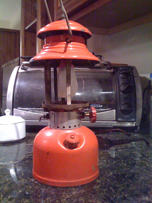

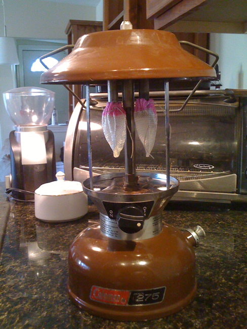

Check this out! $5 for the pair at the Army surplus estate sale!
They both need glass and the "turd" needs a gas cap, which I found at the Coleman website. The glass for the 275 seems to be a bit more elusive, but my question is more on care before I add gas and fire them up. All the parts and gas flues seem clean and rust free, and the gaskets seem ok, but what should I do to avoid an accident?

Wow, just flipped over the 200A and I think it's from 1955. :shock: Definitely not in mint condition though - the paint on the top has some bald spots, but it's charming, to say the least. I'm thinking about giving it to a collector friend of mine - he loves this stuff. I'd love to get it working for him though.

Look on the bottom...should have the month and year stamped into it. Doug

So I'm wondering if it's ok to try to light the stove without the glass? I will try to pick up some white gas today and I'd love to try to get the lanterns to work - or at least see what's wrong with them.
Also, the hood on the 200A has some serious chips and dings. If I decided to restore it, what kind of paint or coating should I be looking for?
@Doug: I flipped over the 200, and the only stamping on it says 55. Nothing else - however, on the side it does have the imprinted Coleman sunburst logo that says "Sunshine of the Night" and the Coleman decal on the opposite side. The 275 is a 1979 model. That one cleaned up spectacularly. I'm more worried about the 200.

Kixwy2 wrote:Also, the hood on the 200A has some serious chips and dings. If I decided to restore it, what kind of paint or coating should I be looking for?.
They are originally porcelain fired. The chips are usually due from the metal cooling at a different rate that the porcelain. You can it reporcelained. Many have tried unsuccessfully to repaint a top with high heat paints - it just doesn't work. Just leave the chips on and let it speak of it's heritage!
Kixwy2 wrote:@Doug: I flipped over the 200, and the only stamping on it says 55. Nothing else - however, on the side it does have the imprinted Coleman sunburst logo that says "Sunshine of the Night" and the Coleman decal on the opposite side. The 275 is a 1979 model. That one cleaned up spectacularly. I'm more worried about the 200.
Yep = you got it 1955[/quote]

Postby doug hodder » Sat Mar 27, 2010 9:32 pm
Kixwy2 wrote:Doug: I flipped over the 200, and the only stamping on it says 55. Nothing else.
No number over on the far left? 1-12? I don't have a 200A that old, but there are about 6 in the garage I need to build for someone else, maybe one of them is that old. Doug
