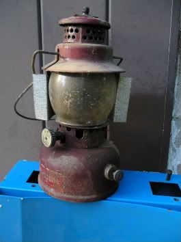

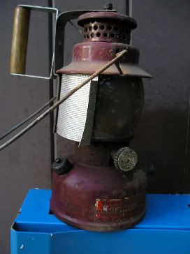

I can't tell you a lot but I do know it was made by AGM and the founts (tank) are very prone to stress cracks. You will want make sure there is no fuel in it, pump it up and dunk the tank in water and check for bubbles.
