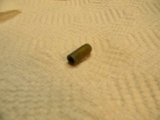

So this lantern follows me home from an auction, ya ever had that happen? BUT, I am a complete lantern restoring novice.
I tore it down, and there was a rattling inside. When I shine a light thru the fuel fill hole and look down thru the fount, I can see a small brass tube that is just rolling around on the bottom !!!
The tube is maybe 1/2" in diameter, 1 inch long and threaded on one end. What is this? Did something break loose? Or did somebody drop this in there? Do I need to fish it out?

Yes, fish it out.
Also take out the plunger and see if the tube the plunger is housed in broke off in the lantern. I've never heard of this happening, but ....?

Okay, fished it out, still don't know what it is?????

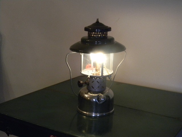

Postby Kevin & Sandy » Mon Feb 28, 2011 10:21 am
Thanks for all the help guys !! With your suggestions, I got the 220B cleaned up and going again. I put it all together and it works like a champ.
I pumped it 25 times, lit it, and it was still going strong 2 1/2 hours later. I wanted to see how long it would go before it just plain went out, but I had to go somewhere.

Did you ever find out what the piece was that was in the fount? I'd be interested in seeing a picture.

Postby Kevin & Sandy » Tue Mar 01, 2011 10:13 am
Mark,
Here is the part I found in the lantern, sorry for the bad pic. Is is brass, threaded on one end, about a 3/8" ID and about an inch or so long.
I had a heckuva time getting it out, finally got it by shining a light down the center, then putting the small end of a little Allen wrench in the part, then tipped over the fount and and snuck it out. :?
It does not thread into ANY threads found on any parts on this lantern. And the way the end looks, it was cut off with a hacksaw at one time??
Maybe someone made a homemade filler and this fell off?

Postby Wolffarmer » Tue Mar 01, 2011 10:26 am
Kind of like the time I pulled the oil pan off the motor from my pickup and among the parts in it I found one that didn't fit anything. And as I was the only person who had done anything with that motor since I had overhauled it, it was a real head scratcher. I finally decided the only way it could have gotten there was if it had been in a bottle of oil.
