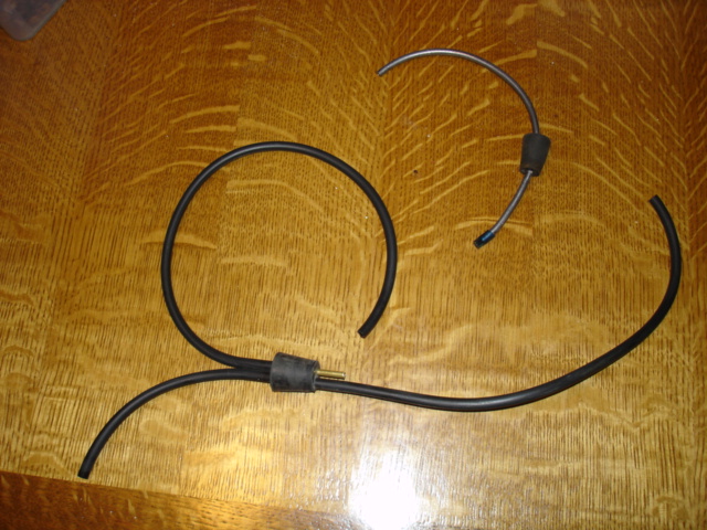

Postby doug hodder » Fri Dec 23, 2011 6:31 pm
Here's what I made for defueling stoves. It's the one with the rubber hoses. I took a 3/4-1"+ rubber stopper, drilled 2 holes in it, put a short piece of hose for the fuel dump...a longer one that will fit to the end of my stove tanks for fuel pickup...and the one that just has the brass tube on the end, for pressuring the tank. I used small brass tube to go through the stopper. If it doesn't fit in the end of the stove...just press it on with your hand....it'll seal enough to empty the tank.
A lot of the older stoves, have a combination fuel filler and pump with an inner sleeve in it. It's impossible to pour out the fuel. Stick the plug in the filler, put the one hose in your mouth and pressure it up...takes about 30 seconds max to drain a tank.
The other smaller one is made by Dave A. Same type of tool, but you plug it into the lantern or top fueling stove, and pressure it up with the pump....same results...dumps fuel in a hurry. If it doesn't fit the older 242's...just hold it on with your hand...it'll seal up well enough to empty it.
I defueled 10 stoves and 8 lanterns in about 45min max...and that includes running upstairs and down with the tanks. Doug
Postby Zollinger » Fri Dec 23, 2011 6:59 pm
I use a small hand crank pump designed for fueling RC airplanes. Also works great on my 242C with it's small hole.

Postby doug hodder » Sat Dec 24, 2011 1:05 am
Well....ya gotta use some common sense. I had to buy the stopper...69 cents...had the rest of the stuff in the garage already.
Like I said Slow...not all stoves can be dumped out. Doug
