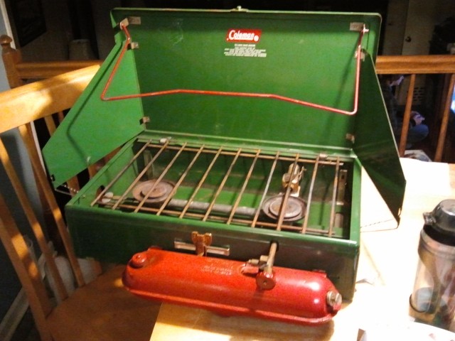

I picked this up today off Craigslist.

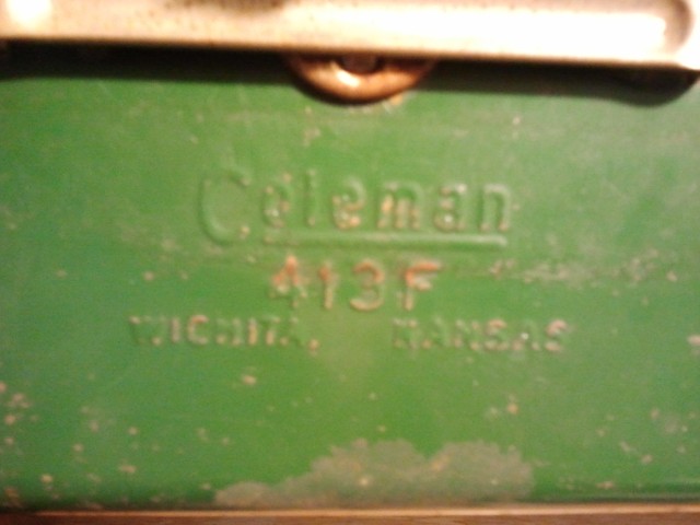

Seems to be a very nice 413F in really great condition. But here is my question. I thought these things had dates stamped on the bottom of the tanks. There is nothing stamped on the bottom of this tank. Where else can the date be.
I does not appear to have been used much, and it looks like it was always stored inside, so I have no idea from appearance how old it might be. The only issue I have found so far is that is does not seem to pump up, so I guess it needs a pump rebuild. I have never done one of those before, but from all I have read here, it doesn't seem to difficult.

Postby DragonFire » Wed Jan 11, 2012 10:26 pm
There is a sticky at the beginning of the 'Vintage Camping Equipment" thread.
It's a link to find your Coleman dates. Check it out..you will be hooked. You will also know where to look on the stove for the dates...I believe it's the tabs that insert the tank into the stove box....and you will get info on what years your model was produced.

Postby IndyTom » Thu Jan 12, 2012 9:35 am
Well, there are no dates visible where the sticky said there would be. It almost looks like there is something stamped on the bottom of the case, but the few characters I can make out are reversed, which makes me wonder if there is something stamped on the inside bottom. I am hoping to get the pump rebuilt so I can cook on it this weekend at the Shiveree. Maybe there will be wisdom beyond mine at the event that can help me date this thing. The exciting thing is, based on the period that the 413F was produced, this could be my birthday stove. We will just have to see.

Postby campmaster-k » Thu Jan 12, 2012 9:56 am
Some stoves have no date on them. You just have to go by when that particular model was produced.
