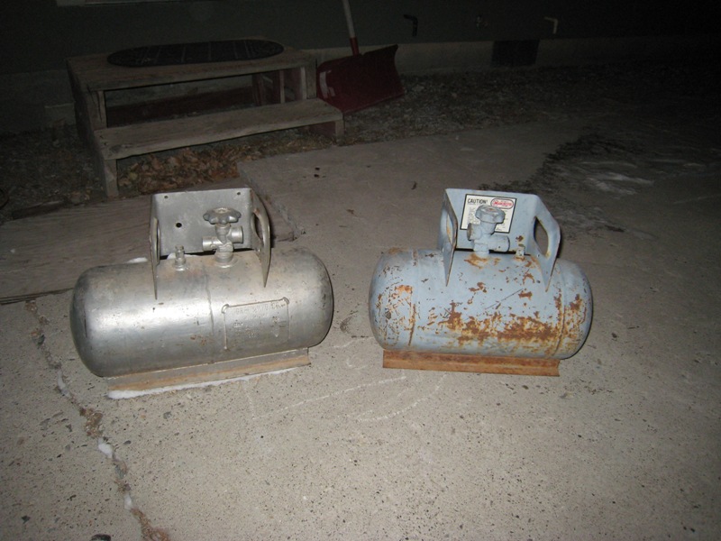

I have been searching Craigslist for about 2 months now looking for a horizonal propane tank to use on my build. I was actually able to locate 2 tanks. I was only looking for 1 tank, but the seller had 2, so I bought both. The are both full of propane also.
They were located 360 miles from me. I just happen to have a co-worker that was heading that way this past weekend, so the seller agreed to hold them for me and my co-worker picked them up.
Dan

Verrrrrrrrry cool. Nice find. No OPD valve required. Now you'll have to clean em up, repaint em, and get em inspected. I had a hard time finding someone to "re certify" some tanks recently. I finally called a statewide propane association and they told me where to go (literally). It was about ten bucks/tank and they just look at the tank, see that it's clean, not too rusty, and then put a vinyl sticker on it with the date of the inspection "penciled in". Kinda hokey but required by law.

I am not sure what I will have to do with the tanks. They are holding propane just fine. I will clean them up and I would like to paint the one that I will put on my trailer. I probably should talk to my local propane company before I paint it. If they are going to stamp it then I would want to paint it afterwards.
