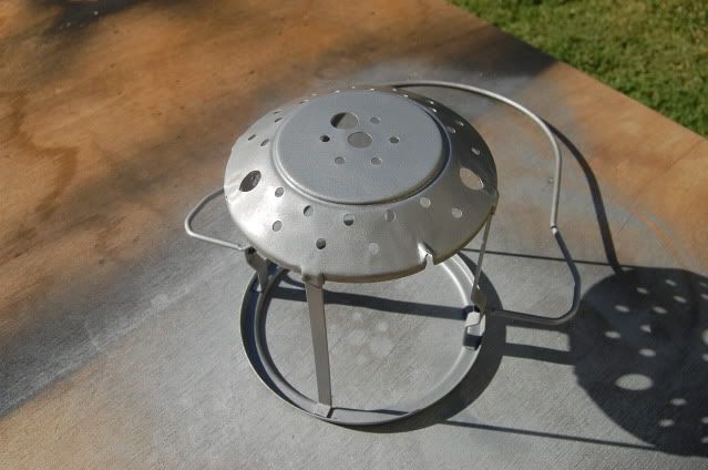

Postby campmaster-k » Thu Mar 08, 2012 9:43 am
Here is that pic I think slow is talking about.
Slow I have broken every rule of painting possible and I have found that the high temp temp always seems to perform. Certainly its better to wait for 70 degrees but we dont always have that luxury.
