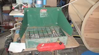

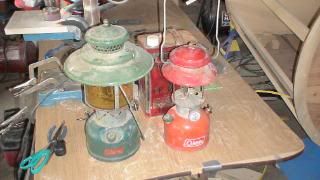

Haven't called on the Kampkook, might call towards this weekend, if I get it for my offer so be it, decided that maybe I should start out restore or refurbishing my Coleman stuff(parts more easily available)my question is where do I start. My thought is to see if I can get them to light and go from there. Oh I have a 1970 200, and a 55 (don't remember model no.)2 mantle, two stoves (oops, again don't remember model no.s)think they are both 2 burner. Would I be disowned if I painted one of the stoves(probably whichever is least desirable)red to match the 200 and the top of teardrop #2. Here are the lanterns
Here is one of the stoves
Thanks

Postby campmaster-k » Wed Mar 14, 2012 8:43 am
I plan to paint some stoves custom colors. I have not done it yet but I will this summer. Just have with it there is no "right way". I always think of what Doug says about painting Coleman stuff ---" Paint it whatever color you want , these things are not Faberge' eggs!"
There is a guy selling old 425's on ebay that he is putting camo on. I dont like it but somebody does.

Postby campmaster-k » Wed Mar 14, 2012 8:50 am
OH hey Aaron - In your pic there is a 228 big hat with a amber globe. Be very careful with that lantern. It is know to explode particularly because of that strange colored glass. The best thing to do is take the glass out and send it to me. I will put it up on a shelf, high up, where no person will ever get hurt by it. If you do that then I think it will be ok the use the lantern. :lol:

Postby doug hodder » Wed Mar 14, 2012 9:12 am
I don't bother to get them running until I put them back together after the restoration. Seems like a lot of unnecessary work if you are going to take it all apart and clean it up anyway. As far as color. I'd only be authentic on the really old stuff that is harder to come by. Something like a 425 or 413 is just a stove to play with and do up how you want. I'm drawing up a custom paint job for one right now. Doug

Postby Aaron Coffee » Wed Mar 14, 2012 5:55 pm
Here are the numbers, 200a dated 5-70, 228F dated 3-55, 425E dated 6-76, 413G no date. Fiddled with them only one cap seems to hold pressure, the stoves both pressure up and light but burn a big orange flame unless I light the second burner. The 228 holds pressure and lights but doesn't seem to be any adjustment, the 200a won't hold pressure, tried all four caps and a different pump.
As far as the amber globe, its a family heirloom, I remember as a kid, someone broke the globe (it was one of my brothers, honest!) We searched high and low and couldn't find a replacement, finally we checked and old seed, feed/hardware store and found this one.

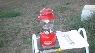

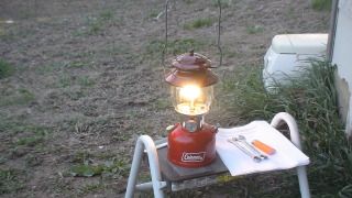

Postby Aaron Coffee » Tue Mar 27, 2012 7:59 pm
IT LIVES, BAHAHAHAHAHA!!!!!
the 200A that is.
Here it is lit
There are a few flaws in the paint. And some chips in the top(the proper name evades me at the moment). Might get it redone next winter or might leave it as I might have caused the chips when I was a kid. I call this one my 3rd birthday lantern.

Postby campmaster-k » Wed Mar 28, 2012 5:18 pm
Aaron Coffee wrote:IT LIVES, BAHAHAHAHAHA!!!!!
the 200A that is.
Here it is lit
Hmm, what next?
Aaron
Great work!
