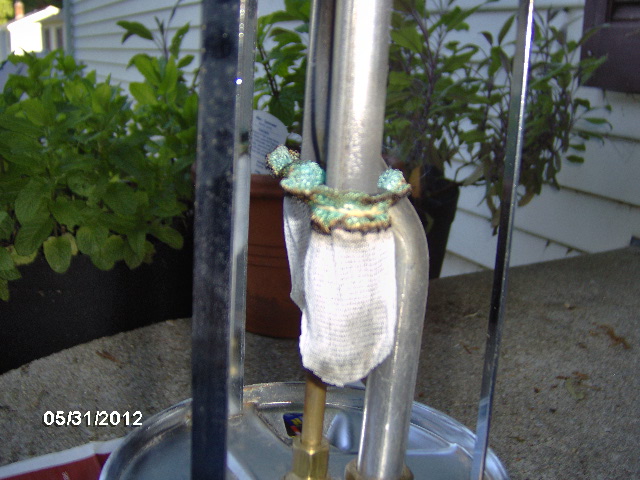

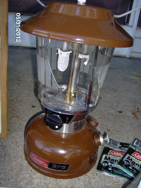

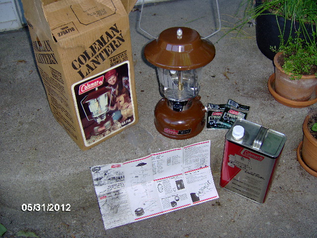

Hardly used, Model 275A Turd, in the original box with 4 mantles and instruction pamphlet.

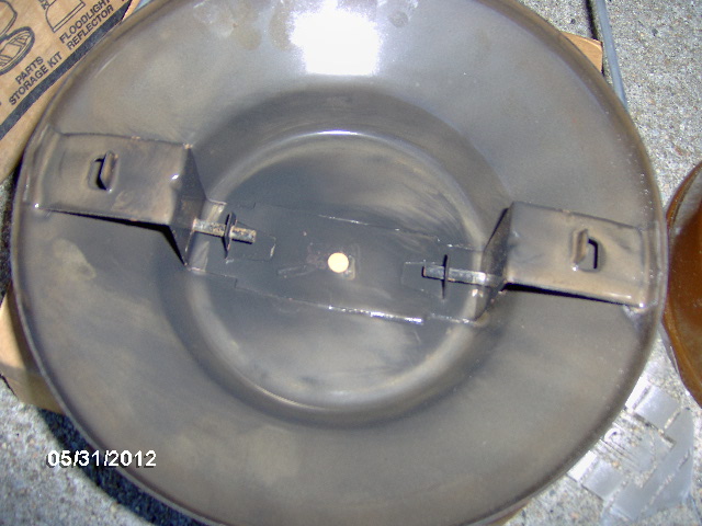

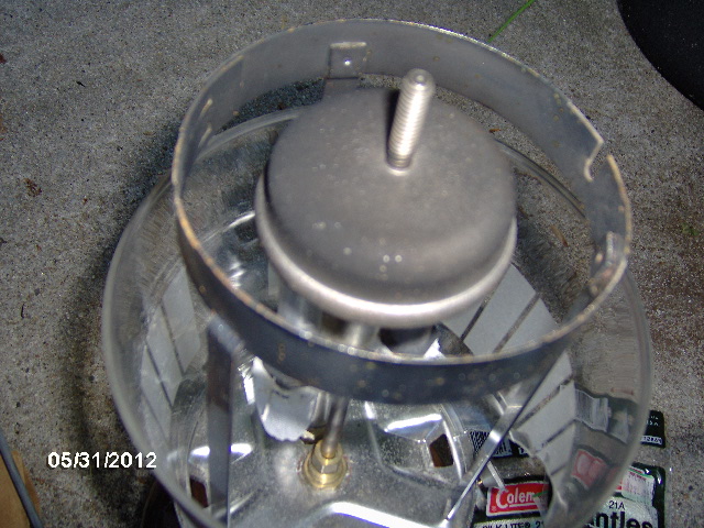

The previous image doesn't actually show all of the soot, but it wasn't bad at all.

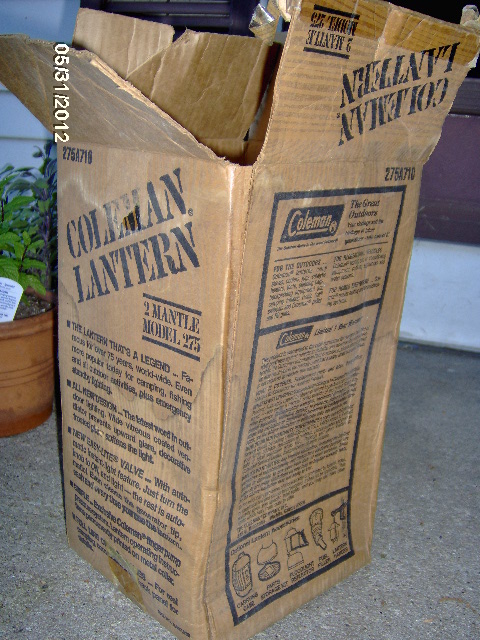

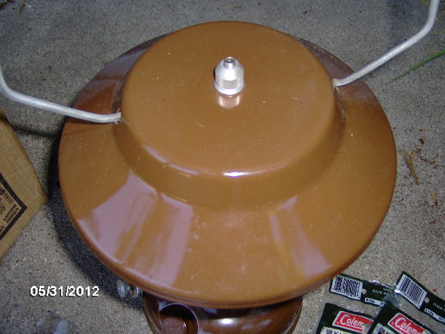

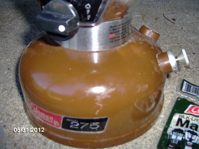

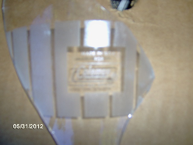

The tapered half frosted/striped globe is broken, the box is a little crinkly and has a some moisture staining, and the pamphlet has some dark smudges on the back panel, but otherwise it seems pretty cherry so far. Slight scuff in the paint on the fount just over the "5" in the "275", and there's a couple of very small dents in the top of the hat that look like someone was not super careful about aligning the top stud when putting the hat back on, but you can't even see those in the pic's so I guess they aren't really there. It's the later 275 with the "ON/Off" knob.
I have already begun looking for a replacement globe and have at least one source http://www.oldcolemanparts.com/product.php?productid=206&cat=32&page=4 ($35+$5 special handling fee), but I am hoping to do better. The clear ones are available cheap.
From what I can recall this is just like the one dad had, except his was the dark green color and had the clear globe. Maybe his fount was taller and not so big around, but that is probably my mind playing tricks on me. I am almost 100% sure that dad's was a one piece hat, so...

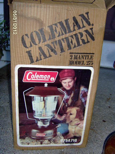

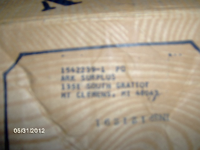

The address printed on the box top says,
1542239-1 PO
ARK SURPLUS
1351 SOUTH GRATIOT
MT CLEMENS, MI 48043

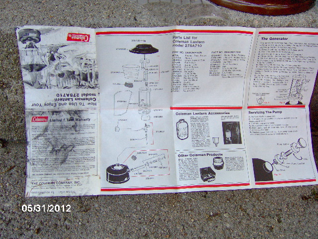

Says "275A710" on each side of the box and "Model 275A710" on the pamphlet. I am assuming that the 710 suffix means the trim option (brown color and stripe frosted globe).
In ball point pen on the box top it's marked "3198", which I take to be the original sales price.

Now a question, is it correct to call this a Big Hat (even though I am assuming that all 275/275A's had this single piece stamping style big hat) or is that description reserved for the earlier styles that were available in either configuration?

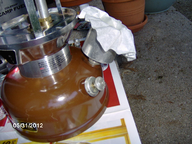

Picked up a gallon of the juice on the way home. Once home I pulled the pump and massaged in a couple or three drops of light machine oil (3 in 1) and smeared a bit more into the pump cylinder with my finger. Pumped right up. The fuel cap seal is fine and the fount was dry inside with an even brown tinge color throughout.

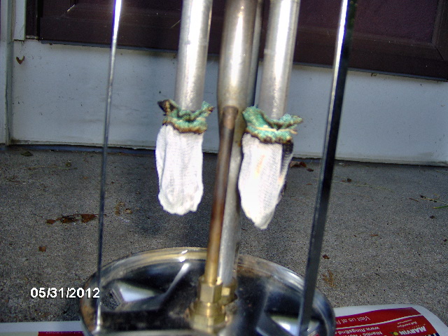

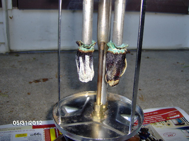

I gave it a wipe down to clean off the disintegrated mantle dust, and a bit of the soot, tied on a couple of the mantles that came with it and toasted them up.
At this point I wished I hadn't done the mantles just yet, because I had intended to slosh some fuel around in it. So I put a bit of juice in using the funnel I got previously (with coffee filter in place of the gennie cloth filter insert).
Sloshed it around and poured it back through the filter funnel into a pie tin. Inspection found no particles or discoloration, so the fuel got poured back in, and topped up.

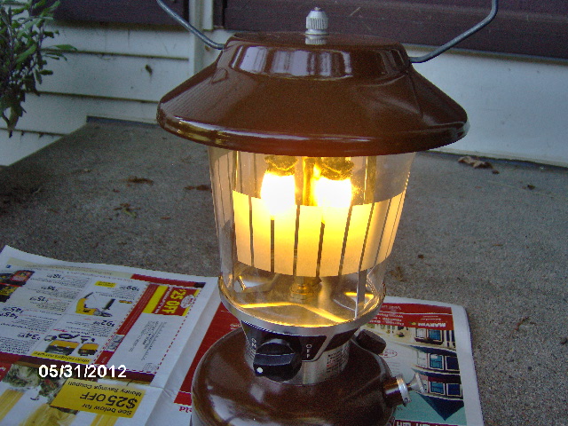

First light.
Lots of little holes in both mantles, probably from me shaking them around while sloshing fuel pre light up.
No big deal, I'm tickled pink! (er...brown) ;) :D

Great lantern. Great pic spread. Great burn. 8)
I am fairly new to the Coleman stuff., but in my opinion the turd is not a big hat. The 228 is a big hat.

The new mantles come from the factory with lots of little holes. Just another feature.

I know the instructions say to replace the mantles whenever they get any holes in them, but what is the real world good practice?

I really don't know. But if there is a hole pointing right at the globe, replace it. That can break the glass or put a permanent smudge there. The first lantern I got back in March 2010 has a crack in one mantel nearly the full length of it. But as is pointing more the other mantel than the glass it has not done any damage. And I have taken the lantern on a few trips. Probably about 2000 miles. Mantel is still holding in there.

:thumbsup: On the peerless mantles. The newer Coleman mantles just suck! They can say what they want about the Turds at the CCF, but it still is my best lighting lantern in the bunch. Good luck finding a frosted globe. They are hard to find. I would buy another 275 in the wild just for the original globe.
