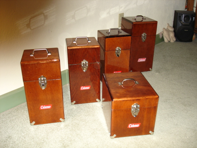

Postby doug hodder » Sat Dec 01, 2012 12:04 am
I've found that if you build a box so that the sides are protected and the bottom of the lantern is captured with wood stops so that it can't move around (felt pads in the bottom), and then put a piece of foam rubber in the top so that when you close it it compresses, it keeps the lantern from moving about in the box. My cases for the 242's are only 7x7x14 and the 220's are 8x8x16. Much smaller than a bucket and stores easier since it's flat sides. I'm not a big fan of the plastic vacuum formed Coleman cases. I've yet to break a globe in one. Just 1/4" ply and some 3/4" material on the corners. I figure if I've got a premium 70+year old lantern...it deserves a nice storage box. Doug

Postby KCStudly » Sun Dec 02, 2012 12:34 am
Very nice work there, Doug. Thanks for sharing. :thumbsup:

Postby Hillmann » Tue Dec 04, 2012 4:24 pm
doug hodder wrote:
I am pretty sure we need more pictures of your boxes, those are pretty sweet.

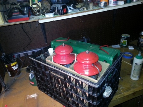

Postby jeporter25 » Wed Dec 05, 2012 10:53 pm
This is not exactly home made but here's what i got. I found that a double wide milk crate holds a 425, a can of fuel. and 2 200as. I did add a bottle opener to the outside of it and its pretty prefect for camping.

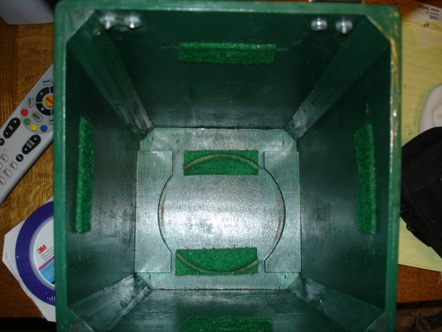

Doug, those cases are excellent. Do you have some pics on the inside? Love to see them.

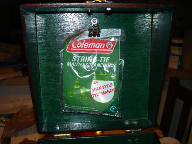

Postby doug hodder » Sat Dec 15, 2012 12:21 am
Here's an inside pic. I cut 2 pieces of 1/4" ply in an arc to sort of capture the base, then padded the bottom with some felt. This one is for a 242. I just ripped a piece of 45 degree material to back up the joint. On the first one I did...I did a box joint. Not such a clean thing to do on 1/4" ply...too much tear out on it. I also padded the sides where the vent might contact the sides with felt as well. I just brush painted out the interior with a decent Coleman green paint. Another easy thing to do is to screw in a small binder clip into the lid to hold spare mantles. Piece of foam rubber holds the lantern secure when it closes.
