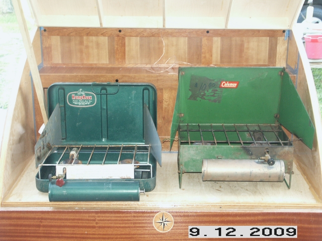

Postby Rock » Wed Mar 27, 2013 10:28 am
That's exactly what I paid for mine!

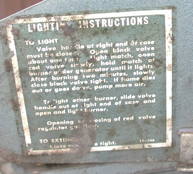

Postby Wolffarmer » Thu Mar 28, 2013 8:00 am
Here is a JPG of the real lighting instructions in case yours is missing. My narative is a bit off.
