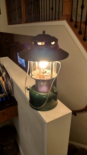

Postby bdosborn » Wed Aug 21, 2019 8:22 pm
I just got a 228F big hat up and running. It has a nice yellow light and the reflector makes it perfect for sitting on a picnic table.

Postby bdosborn » Fri Aug 23, 2019 6:47 am
I had to replace the burner assembly, pump, and cap seal to get mine back up and running. I stumbled on the Peerless mantels when I was looking to see what model number I needed. I think I tied the string to tight on the first batch as they fell of the burner. I kept the mantle string as loose as I could on the second batch and they're working like a champ. The replacement pump has the leather cup and doesn't work worth a crap, I need something a little more synthetic.
