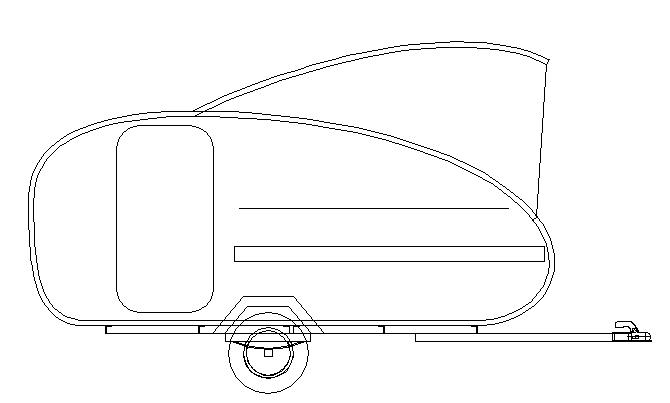

Here is something I put together quickly. It is a rough sketch of a reversed cabin car sitting on a harbor freight trailer. So would be thinner than the actual cabin car. Bed shown is queen size in length. Kitchen would be in the back and inside. You could do something like the campster and raise the front roof if you wanted to put a table in.
http://tnttt.com/album_ ... pic_id=553
I need to give thanks to Angib as mostly what I have done is to downloaded all the profiles and cad drawings he has already done and just play around with them

Postby Ron Dickey » Fri Oct 08, 2004 9:47 pm
[quote="Flyfisher"]Here is something I put together quickly. It is a rough sketch of a reversed cabin car sitting on a harbor freight trailer. So would be thinner than the actual cabin car. Bed shown is queen size in length. Kitchen would be in the back and inside. You could do something like the campster and raise the front roof if you wanted to put a table in.
Fly Fisher ... you are coming close to my thinking.
