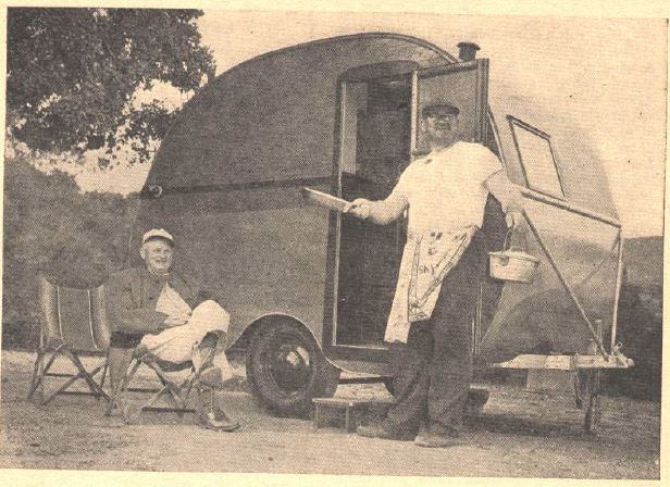

The fundamental thing is the body design has to change to eliminate the thin, flexible tongue or A-frame that cannot be made easily in wood. Instead the whole body extends down to the coupler. The Wanderbug in the Vintage Plans section has some diagonal braces from the body to the tongue that do a similar job:
