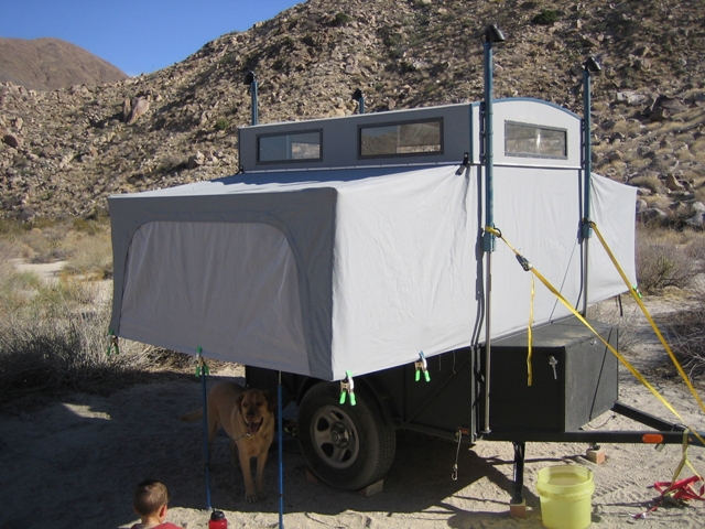

thinking of using the same system to create a small Hi -lo camper build?
starleen2 wrote:Here is another - it does appear to have some binding problems and equalization of lift rates

Check my comments above, I think you will find binding (even lifting) to be the major challenge. Let us know how you make out.
. His struts appear to be simple two segment units and mounted externally (because they are too long to be internal).So what worked well I want to keep? The pnumatic lifts are dabomb. Top goes up/down without any effort. It's nice to have air available at the campsite for air matteresses, bike tires, etc..
