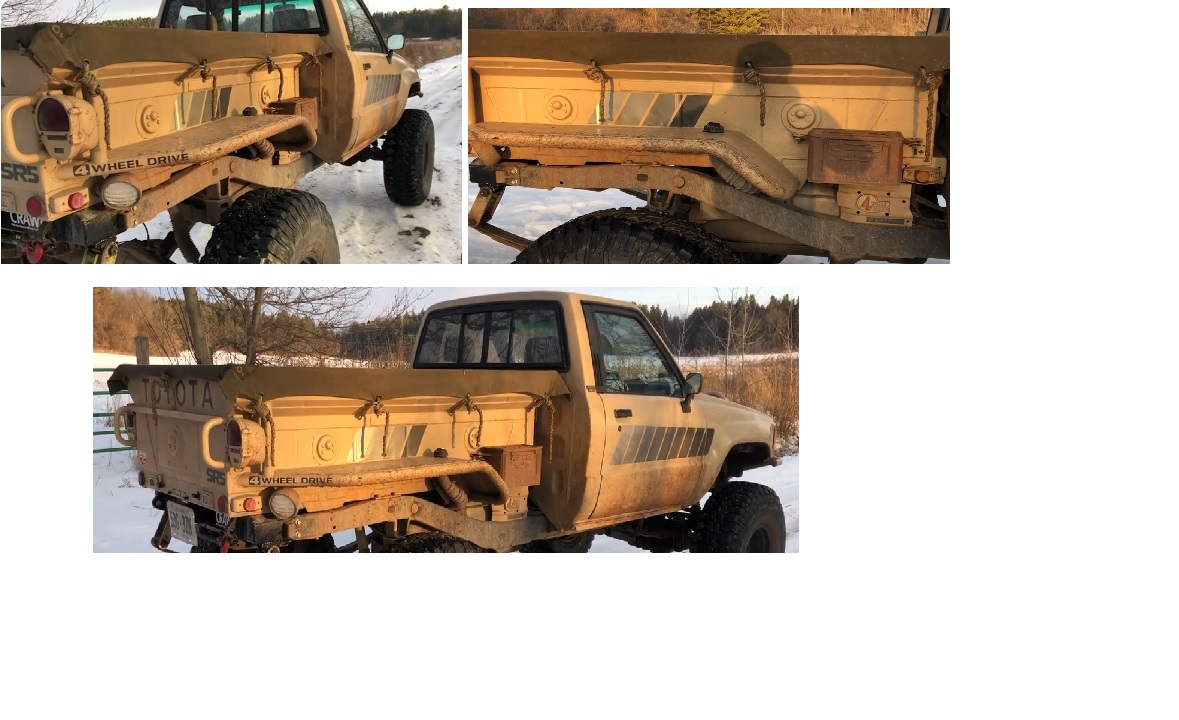

I want to build one and have the layout but curious if I could build it out of alum and rivets.
it would have to have at least 3/8 thick bed floor and side walls.
would attempt to design it after the M101 CDN2 trailer with a tail gate. Including images of the build I want to make but with a CDN ( Without a tailgate )
Any comments or suggestions would be very welcome. I am very mechanically inclined but have never done this type of construction and this idea has driven me nuts for about a month now.

You are most welcome and I wish you all the best with your project. This is a cool looking truck. I do not recall seeing such design in Toyotas rear, was it custom made? I am no expert in Toyota trucks though..

Sorry for the late response Yes it was created by a man in Canada very cool design though. Those bed all rotted and there aren't many replacement options except fiberglass (-_-)
