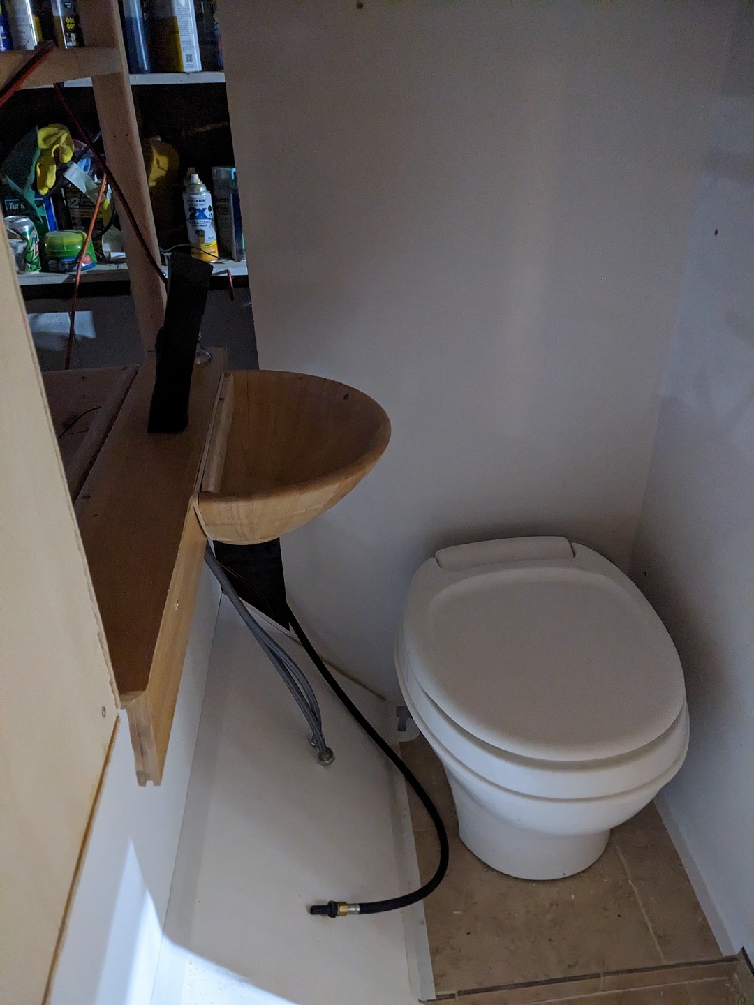

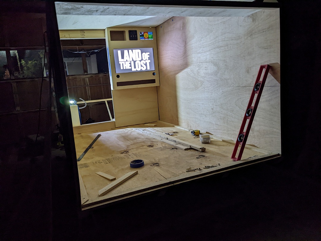

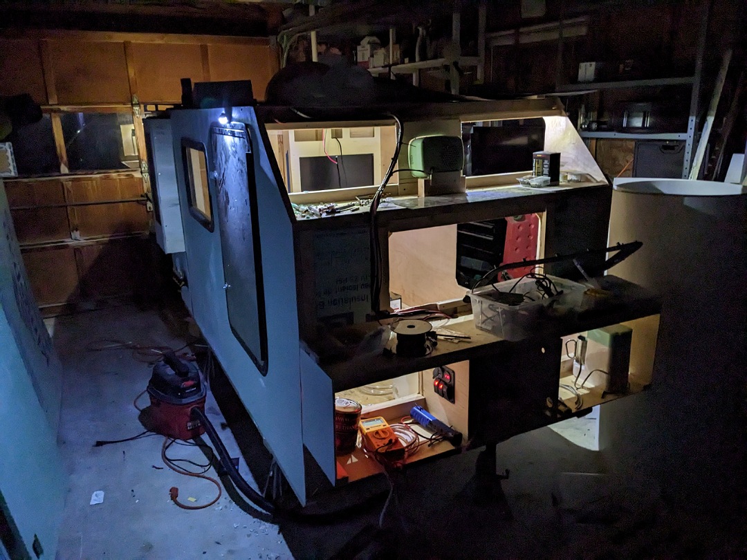

This is my second build based on lessons learned from the first. It has a 6x4 sleeping compartment and roughly 2x4 bathroom. The bathroom has hot/cold faucet and shower, and a toilet. Four foot ceiling. Here are the features:

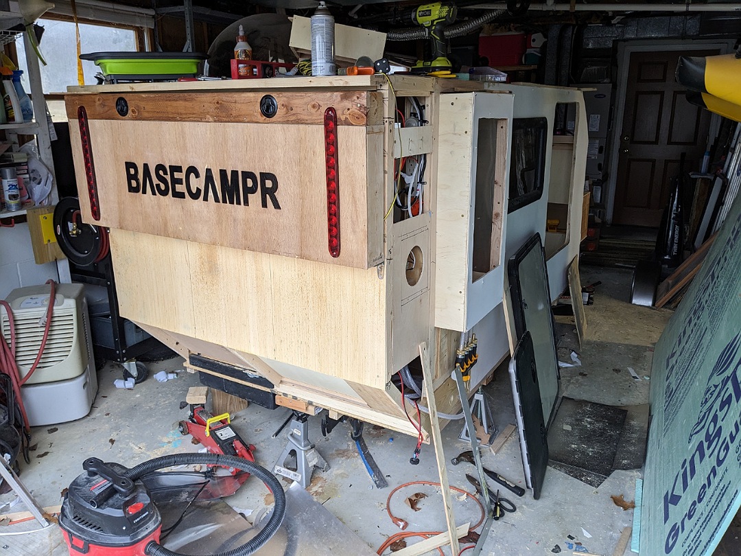

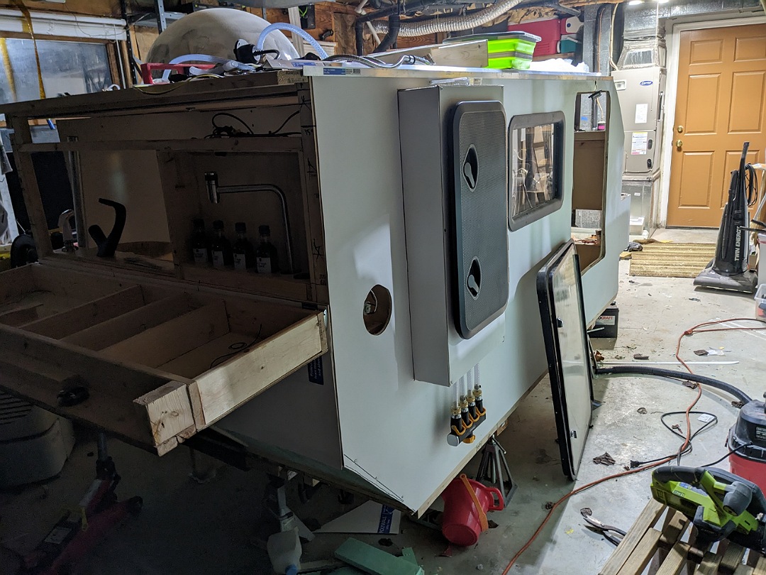

* Skinned in 1/4" sanded ply (inside), 1/2" foam with 1/2" framing, and FRP on exterior. Very sturdy and light.
* Doors are scratch and dent cargo doors. $80 each from Affordable RVing. Will add latches.
* Bought window frames and added lexan from the old camper.

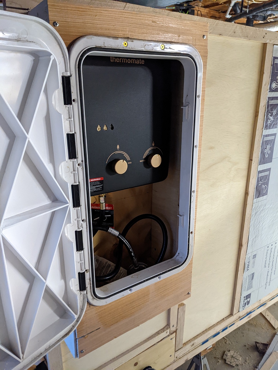

* Propane on demand water heater.
* Bathroom has sliding privacy door and dome over toilet for headroom. Shower sitting down.
* Tiled bathroom floor. Only $4! Cheapest and quickest tile job I ever did. Used construction adhesive and caulk. Very sturdy. Slopes to the drain.
* Water and sewage tanks about five gallons each. Gray water tank will be external.
* Wired for AC and DC. LED lights in cabin, external, bathroom and galley.

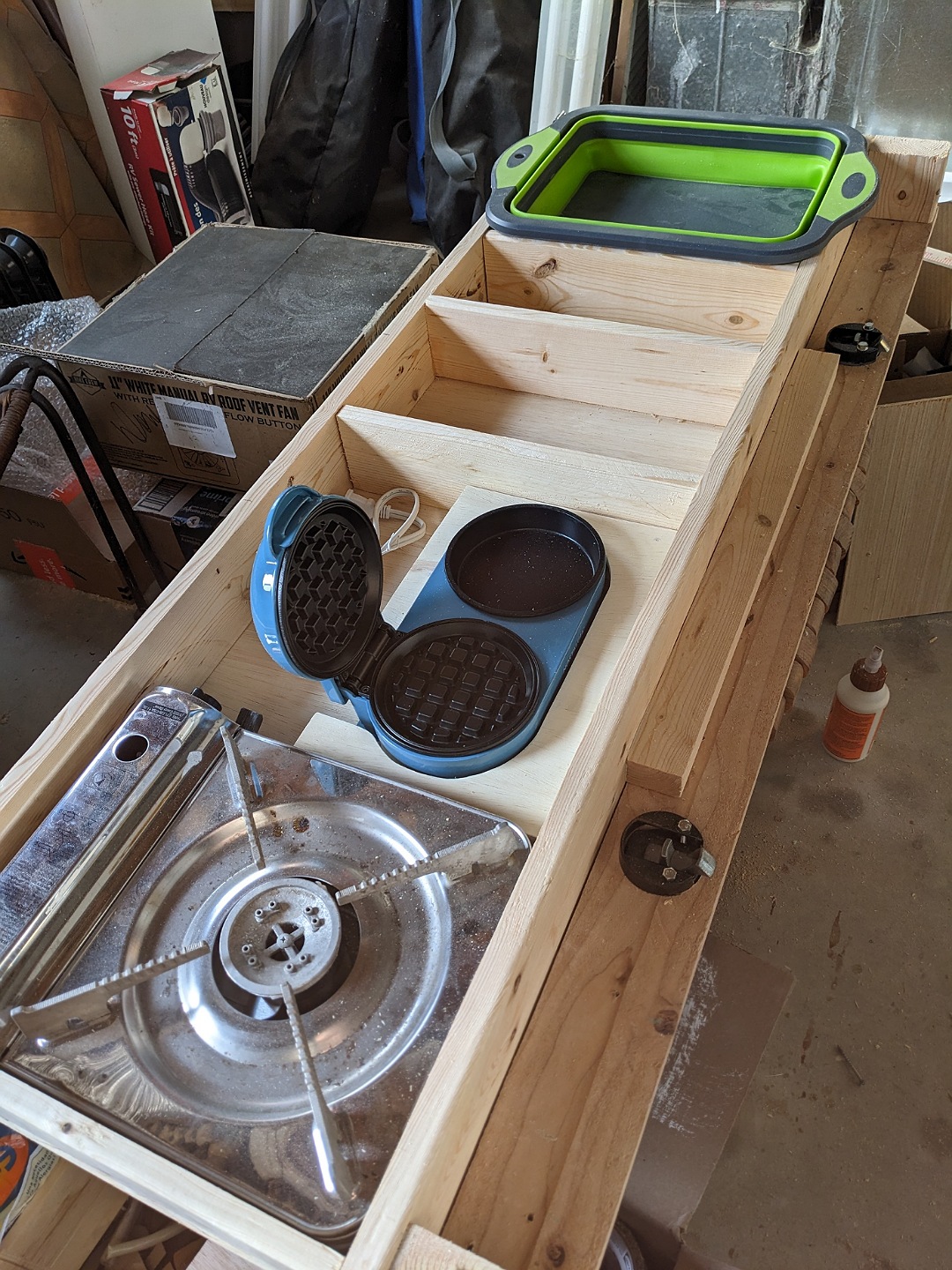

* Galley has butane stove, waffle/egg maker, faucet, sink and storage. Folds down in rear.
* Storage cubbies at head of bed and shelf above. Heater built into shelf.
* Tv with DVD.
My four cylinder Honda struggled pulling the old one so hoping this will do better. It should be much lighter and will sit lower.

Postby Mark Williamson » Wed Jan 04, 2023 7:13 am
A few more photos

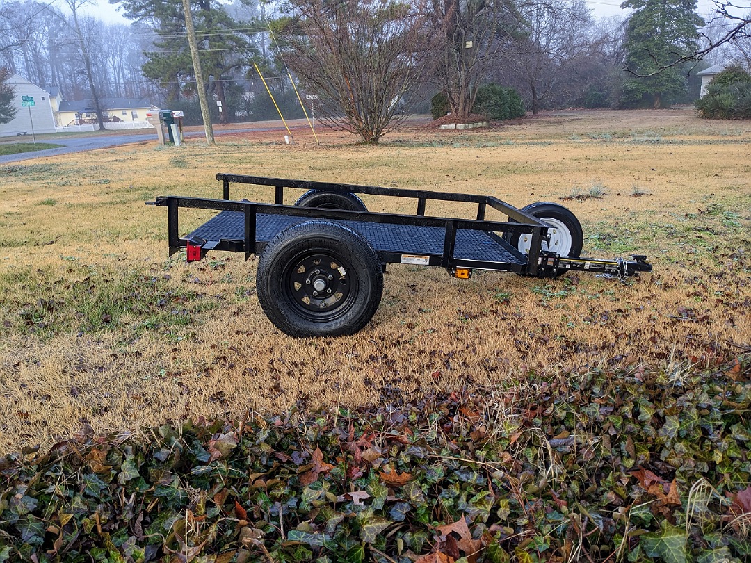

More photos. 4x6 trailer with beefed up wheels. 13" trailer wheels. No need for spacers. The spare is the old 12".
