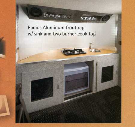

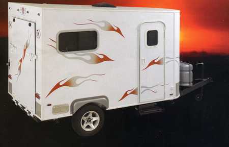

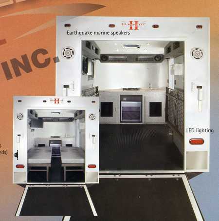

I saw this trailer at the boat and RV show last weekend. It's not exactly what you want but maybe it will give you some ideas. I think it is pretty cool.
You can haul your ATV, back it out, fold down the beds and sleep in it. It even has a kitchen in the front. All in a pretty small package.
If the bunks were wider (extending wall to wall) you could sleep 4 across. Provided your not too tall.
Exterior width:6'6" Interior length: 10'5" Interior height: 6'2"
This trailer just may be one of my future builds! The profile is not the most attractive but it is very functional.

Thanks for the ideas. Did you get any contact info for the trailer, like www etc?

Postby Endo » Sat Jan 20, 2007 3:56 pm
billpool wrote:Thanks for the ideas. Did you get any contact info for the trailer, like www etc?
BTW Nice JP.....!
Not too much info was available at the time. The dealer said it was a prototype trailer, some minor changes are planned for the production model. It is made by Hyperlite.
Hope that helps.
