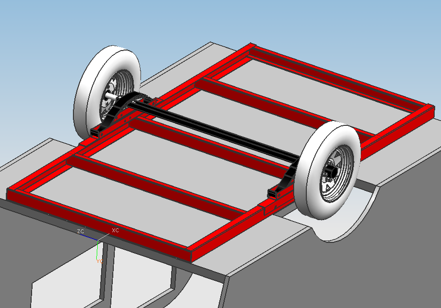

You can build your sunspot on a HF trailer. No problem. It'll have a similar construction to my Winter Warrior where it's attached to the chassis.
The easiest way is to build using the Generic Benroy plans, but with the dimensions and shape of the sunspot.

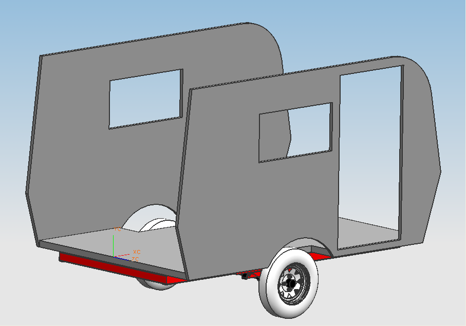

Postby mikeschn » Wed May 09, 2007 5:17 pm
Okay, I modeled it up anyways...

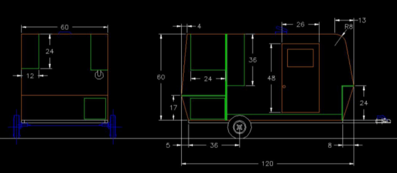

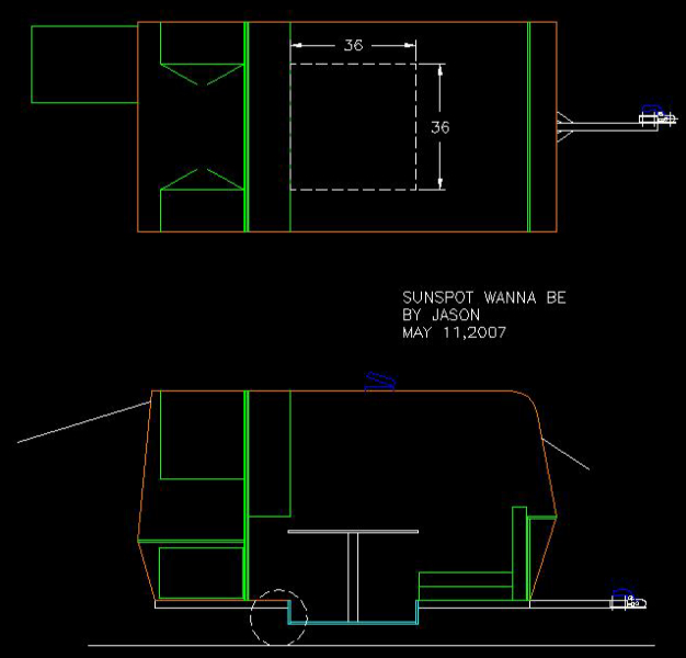

The Mattress is a full size that would be in three pieces and fold up to make seating. The cabinets in the galley would face towards each other and the cooler on the bottom would be on a slide out. And the other side would have a slide out table that would be as deep as the counter. I think a drop floor would make for a good seating area and the removable piece would make the table top just not that far yet. The 36 in. cabinet would be a 24" and 12" the 12" part would hold stereo, speakers and pull out shlef for laptop/dvd player.

Postby wa_flyfisher » Fri May 11, 2007 3:37 pm
A little more work done today at work :thumbsup:
