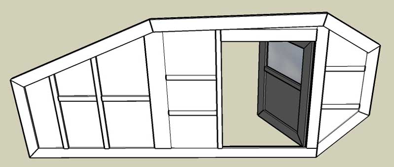

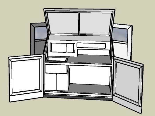

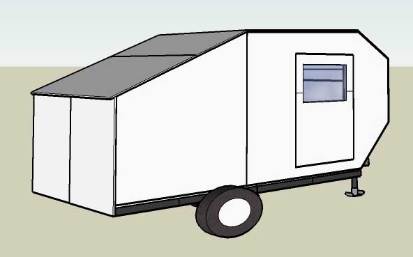

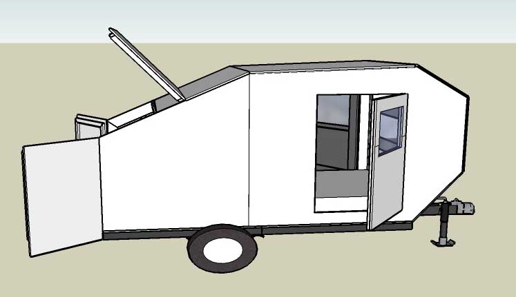

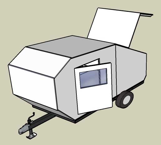

so here are the 2 designs I have been working on. both are based on the weekender design (thank you by the way for posting that info, it really helped).
I would appreciate any opinions you guys have on these designs. I am going to build it on a 4x8 trailer either custom built or a harbor freight. the biggest challenge we are going to have is that I want to be able to remove the camper shell so I can use it as a regular trailer if the need arises.
Anyway, thanks for your opinions in advance. I won't be starting the build until about the end of May or early June when I finish college.

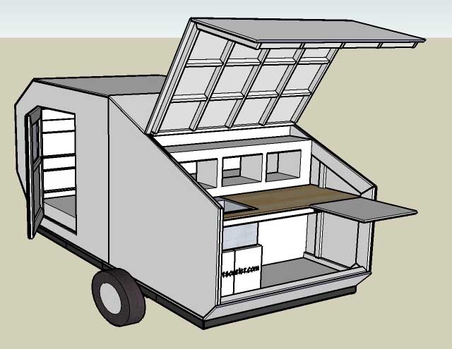

Option 1:

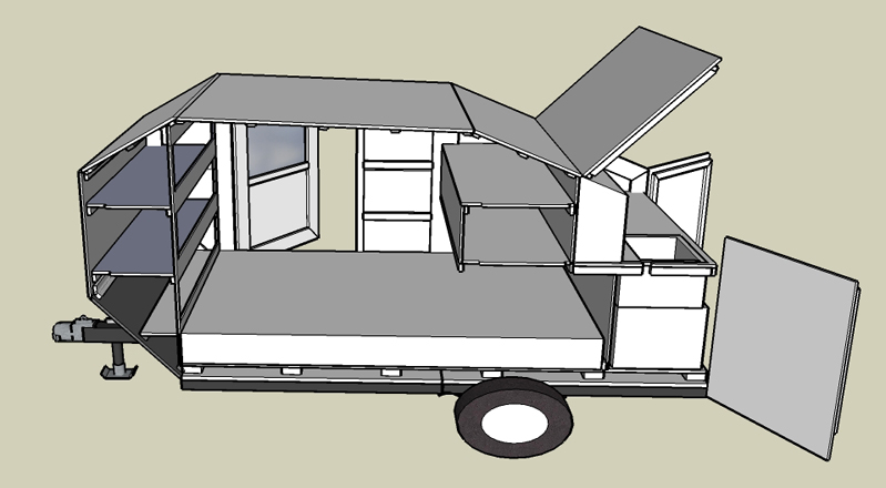

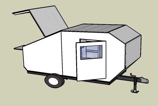

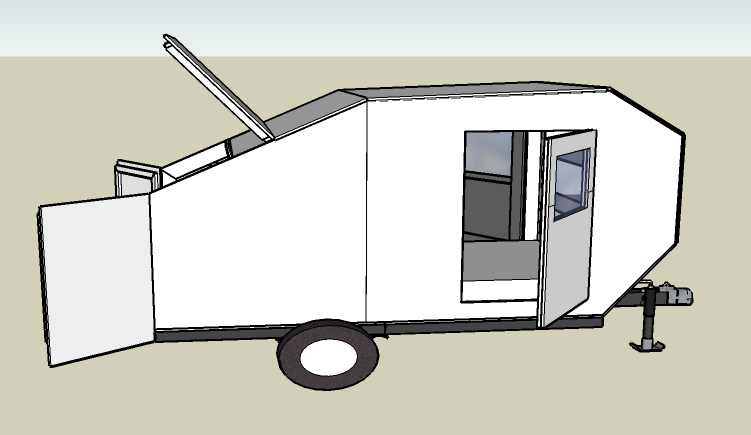

And option 2. The only difference is in the hatch. this one uses a more traditional style with the larger one piece opening.
The gallies look different, but really I haven't decided yet on what it will look like. From what I have seen, for every teardrop there is a different galley customized to be what the owner wants...

Postby Wimperdink » Sat Jan 26, 2008 11:24 pm
Nice work. I'm always up to give my opinion.... I perfer the one piece opening. It gives 2 less seams to seal from weather, and gives less obstacles to move around while setup in camp. Ask for my 2 cents and you'll get exactly 2 cents worth. :lol:

Postby George Kraus » Sun Jan 27, 2008 8:14 am
How much distance do you have between the front overhang and the tow vehicle?

Postby kid_kaboom » Sun Jan 27, 2008 10:54 am
I honestly don't know because I don't have the exact dimensions of the trailer yet. This was just a model that someone posted on the sketchup website and I am using temporarily. I can tell you that the front part of the shell overhangs only 16". It looks bad in this picture because the trailer's tongue is only 30".

Postby bobhenry » Sun Jan 27, 2008 11:22 am
Take my advice if you can jackknife the box into the tow vehicle lengthen the tongue right away. I crunched Chubbys lexan roof in a moment of stupidity. Ira has a pic somewhere where he crunched a corner out of his tongue box. I will be installing a longer tongue this spring. My tongue weight is 2 fingers at level 10 maybe 15 # and its just not enough at 65 the tear wants to dance a bit. Below that it tows like a dream.
Postby Ivar the Red » Sun Jan 27, 2008 2:54 pm
Hi Keith,
Welcome to the forum. IMO I like the three piece hatch. True, there will be more seems to worry about leaking, but it sure helps when you're not good at cutting curves. :lol:
