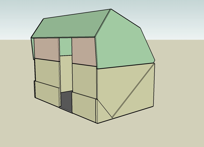

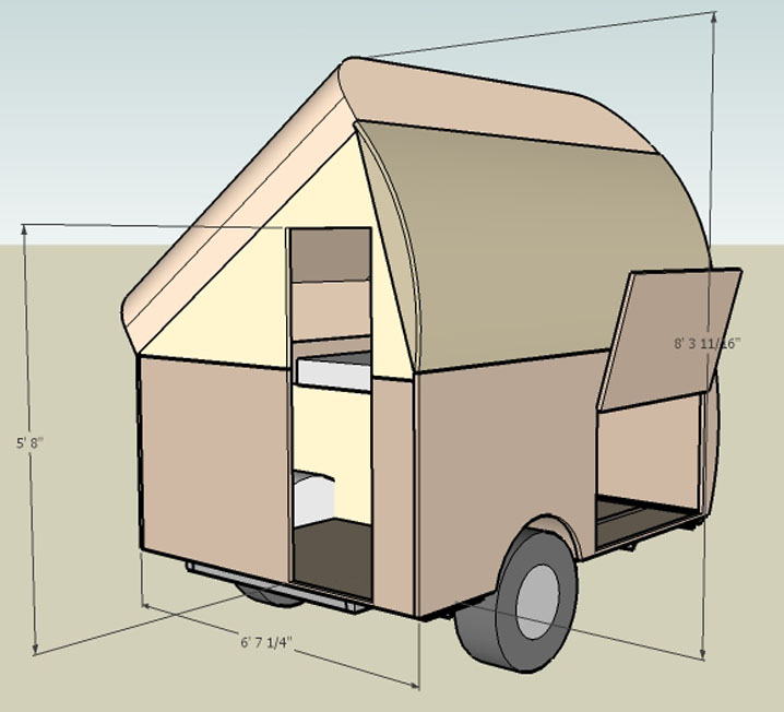

Mike, I have simplified a bit, mainly by dropping the side walls on the roof sections. Now the inner roof has ends to seal to top of body, and the outer roof has an edge to lap the joint both when closed and open. This should be pretty simple to build, operate, and seal. I studied some pix of the Aliner Truck Cabin, and also found the patent with lots of diagrams. Did you have something else in mind?
Barrie, that is quite an impressive-looking outfit, but I agree that the canvas puts it out of the game. My design also provides lots of headroom, both in the standing portion and over the bed.
Andrew, an interesting car, indeed!
Cliff, you're right, it's a poor website. Found the patent for that design, too, but it's pretty short on details, just like the site.
Brian, you forgot the steamer above the headlight, for de-wrinkling your clothes (I guess...).
Keep in mind that all I'm after is weather-tight, fairly secure sleeping accomodations, and plenty of space for all the "stuff" that makes camping the joy it is. Most all camping time is spent outside, especially the cooking. I want a low-profile rig when towing (and storing), but plenty of height when in use. So here it is, again...

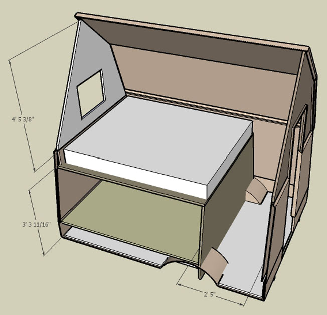

Here is Aliner's solution to more space (and a shower?), well worth copying...

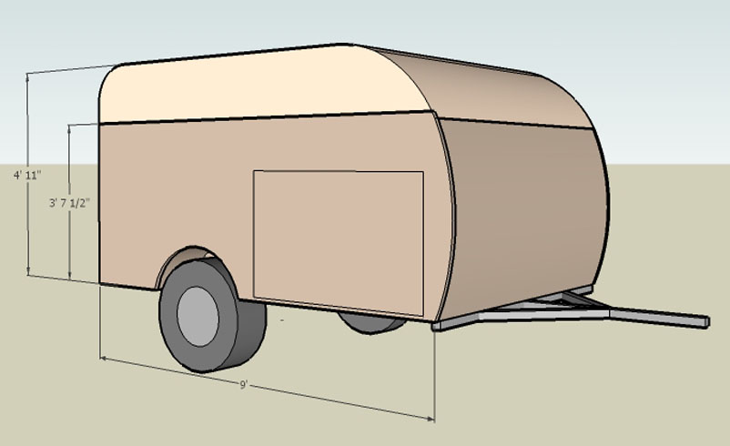

Instead of having the top open as you have in a folding fashion, which would be difficult to seal, why not have a box within a box configuration? The top box having a roof, and being smaller than the bottom box, fitting inside it. Or make it larger than the bottom box, covering it. Then you would simply have to crawl inside and lift the top box up, or come up with a crank assembly to do this for you. Like the Hi-Lo campers. http://www.hilotrailer.com/hilo.html
Or hinge it like this......http://www.hilomojo.com/mojo_index.html
I know the Hi-Lo's have a rather sophisticated canvas system that seals the top to the bottom, but I think the idea would work on a small camper where the top box fits inside the bottom. Then when lifted up, a canvas attached to the lower edge of the tops sides could be lapped/flapped over the top of the bottoms sides.......I don't have a way to illustrate what I mean, but I hope the thought comes through.

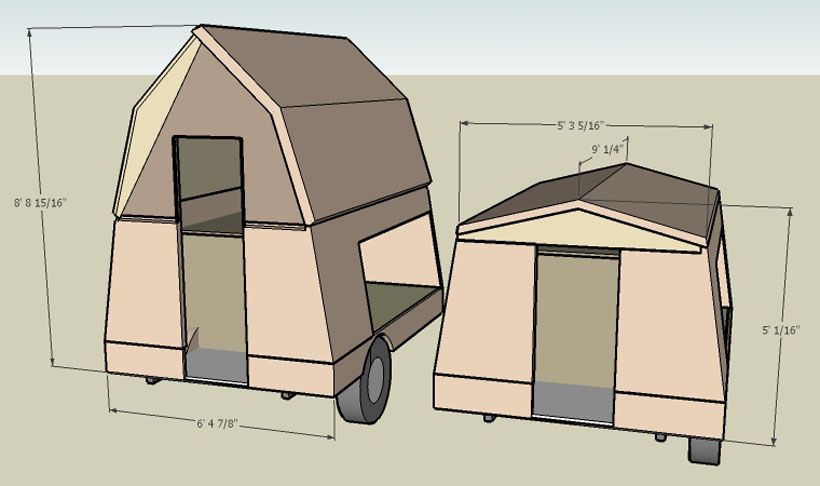

Here's another take on the concept, this time with a shape that may please more of the 'drop fans, yet still has all the advantages of height and storage...
