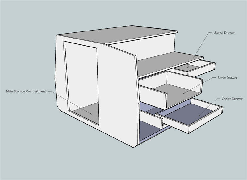

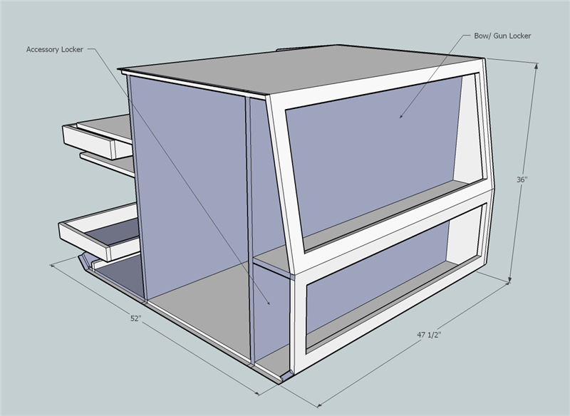

Concept: :thinking:
Compact gear hauler w/ a full service Galley.
Main Compartment to double as a Transport Kennel for dog during hunting season.
Secure storage for Bow and Shotgun/Rifle.
Here is the Concept:

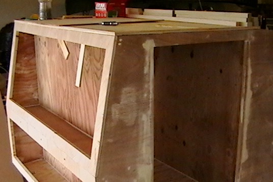

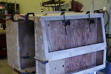

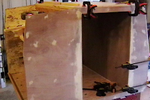

The Carcass is coming togther,
The dividing bulk heads are dadoed into the walls, deck, and roof.
I had to do some work to the Kennel door openings because of a mis-cut. Biscuit joiner, lots of glue, putty and viola!

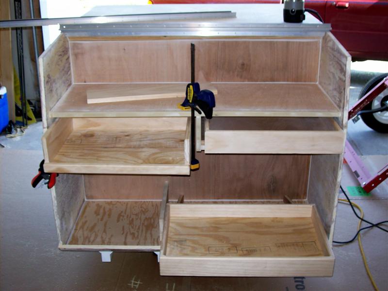

Postby dsmith » Wed May 13, 2009 1:26 pm

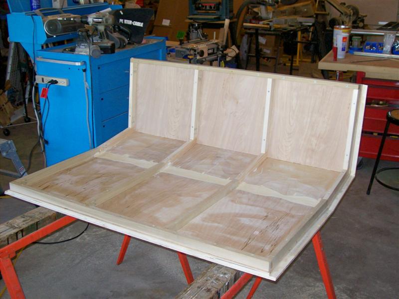

Work has been nuts so not much progress until the past few days. I completed the frame and skin for the hatch.

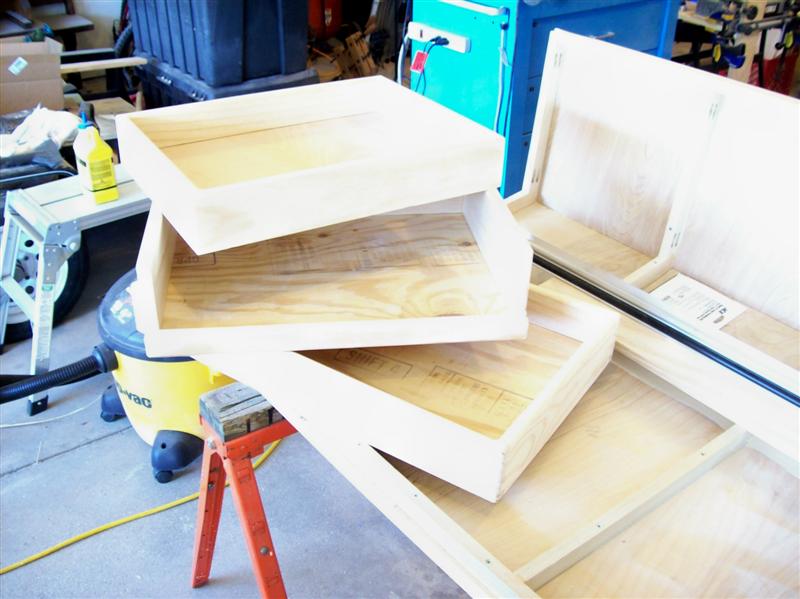

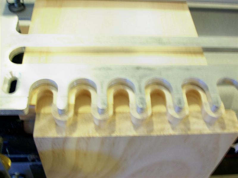

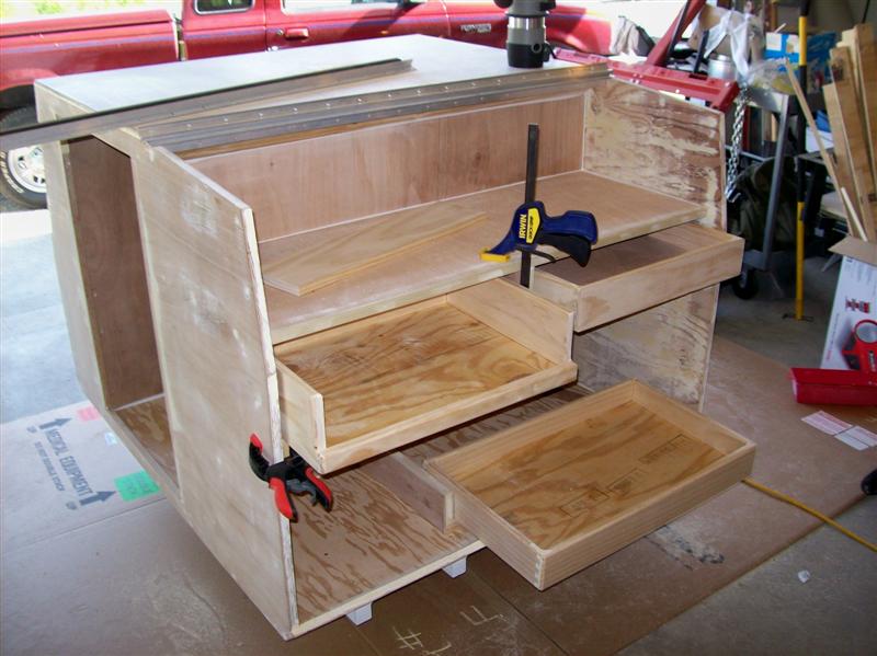

And finally got to use my dovetail jig for my drawers and pull outs, a great joint for strength and durability!
From top to bottom: utensil drawer, stove drawer, and cooler drawer.
I also cut one Grant Whipps Hinges to fit the hatch. I left a 3/8" over hange on the leading section, and cut the trailing edge flush with the hatch. The inside strip I rounded over and trimmed it another 1/8" on each side.
I love this hinge!
Unsolicited Testimonial-Grant shipped out the hinge within two days and they arrived in perfect condition! :thumbsup: :applause: :thumbsup: He also kept me posted as to the process, order received, shipped, etc. I ordered three. one for the galley hatch and the others are for my front compartments.
Here is couple of pics of the galley mocked up.
