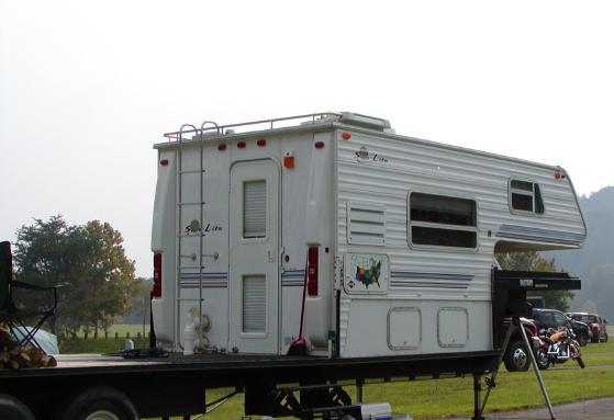

I have had two redneck toy haulers. The first was a cap over on a flatbed bumperpull. I parked the quad under the cab over open space. My next one was on a gooseneck trailer like the one above and then we just put the toys on the rest of the trailer. Man we could haul some toys on that dude. I do not think there is any way to make it look like it is not a truck camper on a trailer unless you were to pull and reside the whole trailer to look like it is just a camp trailer. By then you could spend way to much on it IMHO.
