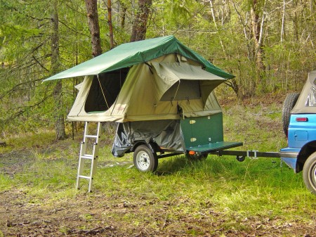

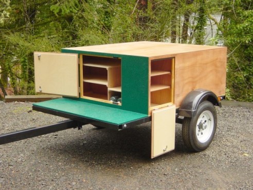

fornesto, here is a standard type box I do on a 4x6 frame. It's easy to "super-size" or shrink as needed.
You can build this style as a Gear Hauler, ChuckWagon or Tent Topped Camper.
I haven't done one yet but it would be easy to make a Teardrop style trailer, then add a folding Tent Unit on top as a second bedroom.
You might also check Navigator's photo galley, he has a gull wing door style Gear Hauler.
