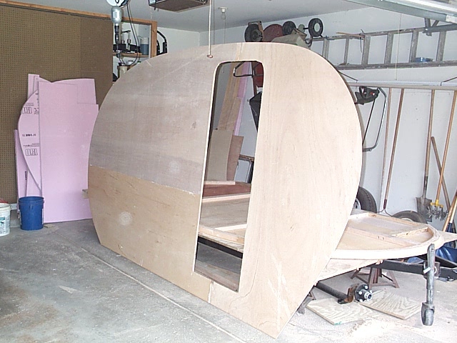

Postby ktm_2000 » Sun Jul 05, 2009 10:17 pm
Here's a pic
With all the slope on the backside, were should I mount the lights?

Postby Carter » Mon Jul 06, 2009 2:30 am
That profile looks familiar. I mounted my tail lamps about 20" up from the bottom on the undercut of the back curve. Made some tapered spacers from 2 1/2" black tubing to get them level. Lamps and plate don't extend past the longest part of the body so I won't run into them. The side markers were placed near the longest part of the body front and rear.
You can see I have 3 lights at the top front and rear. As the trailer is just under 80" they are not required. Just couldn't resist more teardrop lamps.
