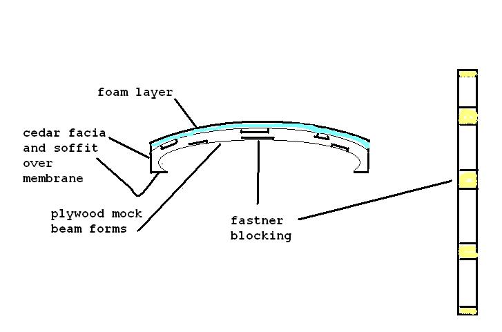

Postby bobhenry » Tue Aug 23, 2011 7:55 am
I have been pondering how best to cover the osb walls in the 4 x 7. The avenue I think I have chosen is to cut 3/4 blue foam to fit and then wrap with quilt batting and a somewhat durable yet colorful choice of yard goods. Simply wrap and back tape the devil out of it. There are some very good tapes that will hold up well. I have been using a construction tape for osb wall seams and it will actually tear wood fibers out of dimensional lumber when removing it. I will simply use some contact adhesive as well as relying on a good tight friction fit to install the finished panel.
For your vardo I would cut several pairs of plywood bows (these would be your spars) and fill between the pair with several small 2x3 or 2x4 as a fastening block top and bottom. On top simply fabric wrap a few cut to fit sheets of 3/4 to 1" polyisocyanurate foil faced insulation board and back tape and attach to the top of your bows. By cutting 4 sheets to cover the entire area you could create a checker board pattern by covering them with different materials.
Then under each mock beam take a contrasting material and blouse it full and install it on the underside by making a small slit in the material and screw thru a backer of 1/8" luan and foam.
By staining and antiquing the face of the bows it will give the illusion of big heavy beams without the weight. Your roof is fully decorated and insulated (oh by the way foil side up to reflect the summer heat). Install the steel or aluminum roof as planned by screwing into the fastner blocks or better yet install perlins full length and box the side facia and soffit to protect the fabric. A ice dam membrane or heavy poly water barrier at the edge would be a good bit of insurance to protect against water intrusion.
