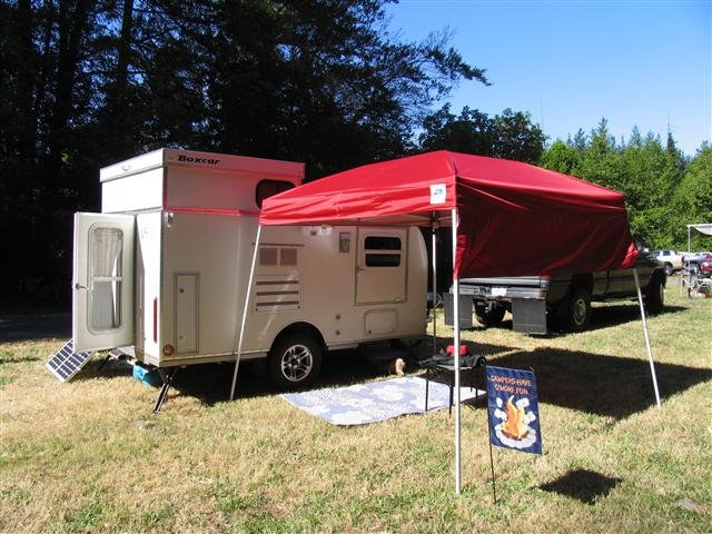

Postby bdosborn » Sat Mar 10, 2012 10:59 am
S. Heisley wrote:If you go with just one single door on the back, it's best to have a second exit for emergencies. A window can work for that. Hopefully, you'll never need it; but, one never knows!
That's what I did:
No complaints so far...
