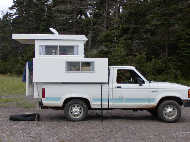

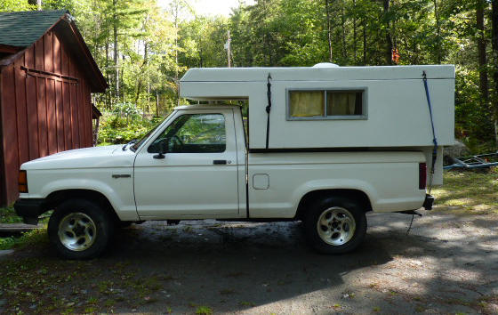

About 4 years ago I posted some details of a pop top camper I had built inspired by Andrews original plans (now changed) for the Compact 2. The camper has seen a lot of use, 4-8 weeks a year on the road, a few problems with the original plywood and the desire for more space lead to a major renovation project last winter, I promised a few people some pictures, so here goes.
The original camper
The renovated and extended camper, the new top is made of foam and fibreglass and weights a bit less than the original wood frame and plywood version.
The top part way up, it weights 40-50lbs but I find it quite easy to push up providing I have a big pillow on my shoulders to prevent my neck taking the load.
All the way up and one off the side pieces nearly up
Completely up, this process takes about 2 minutes actually putting the top up takes a matter of seconds most of the time is spent taking the straps off and sliding the weather stripping plates forward.

I'll see if I can get some better pictures in the next week or so, I have to take part of the cupboard apart to get at it, I'm redoing the cupboard doors so it won't be a bother then.
Basically the lift mechanism consists of a 5/8" steel shaft that some light steel cable wraps around as you turn the shaft, as the wire is wound in it pulls a 1.5" steel tube vertically up. The steel tube has a set of removable wheels on it that push on the underside of the lifting top roof.
The are some snags with this arrangement first the geometry is poor, the roof lifts easily at first but to get the last 20% of lift it is easier to push the rear end wall back by hand, even so it does all the heavy lifting required at the start.
It would be best if the single lift tube was on centre, I had it about 3' along a 7' roof and a foot off centre, it seemed to work OK
The is no brake in the system, if the removable handle that turns the steel shaft came out at the wrong time the whole thing could come crashing down.
With the new roof being a bit lighter I haven't bothered with it, the new roof measures 6'x9'
I guess the maximum width would depend on your truck ours is a Ford Ranger, our camper is 6' wide which gives 5'9" for the bed, I'm 5'8" so it works out good. On my truck I think I could probably go another couple of inches on the width without problems, try measuring a few commercial rigs some look quite wide.

Postby Sadie » Sun Dec 18, 2011 8:22 pm
On the top the is foam weather stripping 3/16" thick and 3/4" wide sold in auto parts stores to install canopies on the back of pickup trucks.
So far I haven't had any water ingress on the highway, the original securing straps weren't capable of compressing the foam and I had no problems. With the new top being a bit more flexible I now use straps that can compress the foam, normally I put minimal pressure on the foam.
The straps are the type sold in auto parts stores for securing loads and have a built in ratchet/winch.

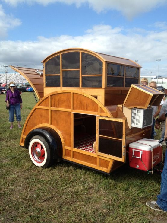

I saw a pop up Teardrop Trailer on my wife's Facebook account. I believe it was in a post at the Vintage Camper Trailers website.
I will try to post a picture but I am new here and not sure how.
Meanwhile here is a link to the site where I saw the pic.
https://www.facebook.com/photo.php?fbid ... =1&theater
[album][/album]

:thumbsup: Wow I love it that's a work of art
