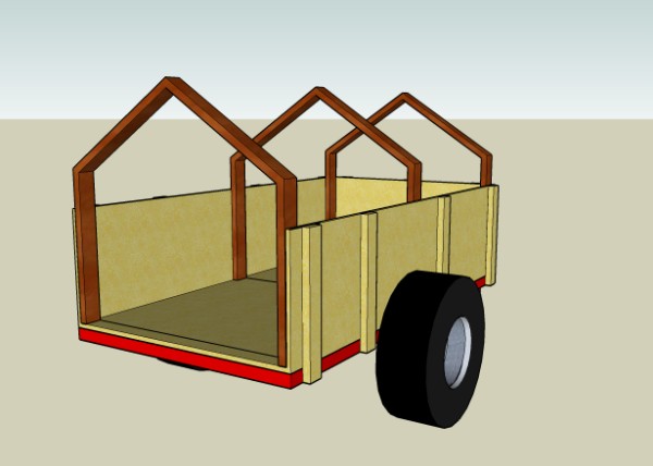

My new, and more feasible, dream is to build a multipurpose trailer -- something I can use to haul kayaks & motorcycles, and use as a utility trailer. To make it perfect, I want to have a shell of some type on the basic teardrop principle -- but the catch is, it has to be removable so that I can use the trailer for multiple purposes. The idea is to have a shell or box of some type that can be broken down and stored, then reassembled when it's time for a camping trip.
I'm starting with a boat trailer that I will have modified in order to add a flat floor. Between the fenders it's four feet wide. The flat floor will probably end up being 9 to 10 feet long overall.
The basic requirements are...
• lightweight (1 person put up and tear down)
• 4' wide by about 7-8' long (I really don't want to have to move fenders around)
• modular construction (removable, breaks down for storage, and durable enough to stand up to repeated assembly and disassembly)
• hard sides (more secure than tent sides for a woman traveling alone)
• roof is weatherproof
• cheap! meaning inexpensive, I don't care about tacky

Postby cuyeda » Fri Sep 19, 2008 6:18 pm
And you want it to be rain proof?
How about 4 plywood walls, plus roof. Use door hinge brackets to pin it all together. Add door, and window in the proper areas. Build kayak rack on top or separate support structure. Bring tarp for rainy weather. Go camping.
What are your ideas?

Postby angib » Sat Sep 20, 2008 10:24 am
A completely rectangular box made from 1/4" ply with 1x2 framing should be quite doable. I presume you'll want a floor on the trailer, so that could stay permanently in place. Bolts every 12-16" along the joints could be carriage bolts with either internal nuts (for security) or external wing nuts (for ease of assembly, but at the risk of barking your shins on them). Each panel should weigh about 50lb (a bit more for the ones with doors in them) so reasonably manageable.
But the dissassembled body is still going to need nearly half the space that a complete body needs, and a lot more work to dismantle and reassemble it, so I suspect you'd be better off with a removable but not-dissassembleable (like the new word?) body. Alternatively, put big doors in the back of the body and take the bedding out to use it as a utility trailer.

Postby cuyeda » Sat Sep 20, 2008 1:16 pm
No collapsible walls but, find a used truck bed shell. Look for the lighter ones. Build your utility trailer. Use fasteners of your choice.

Postby satch » Sat Sep 20, 2008 2:14 pm
I agree with Anigb, a removable box would be a better bet. A break down might start to vibrate loose on the hi-way after being assembled/disassembled afew times. It just sounds like a lot of effort to work, or like Cliff said, build a short box and cap it with a truck shell. jmo 8)

Postby PaulC » Sat Sep 20, 2008 6:40 pm
Another Bright idea from the land downunder :R Build the utility trailerwith removable sides. Once the sides are off you can erect your tent on it. Saves on room, space and unnecessary over engineering of a simple concept. 8)

Postby Mstro » Sun Sep 21, 2008 9:32 am
Take uti8lity trailer with sides, insert fold out frames, brace to sides, and cover with a light weight material that meets your needs
